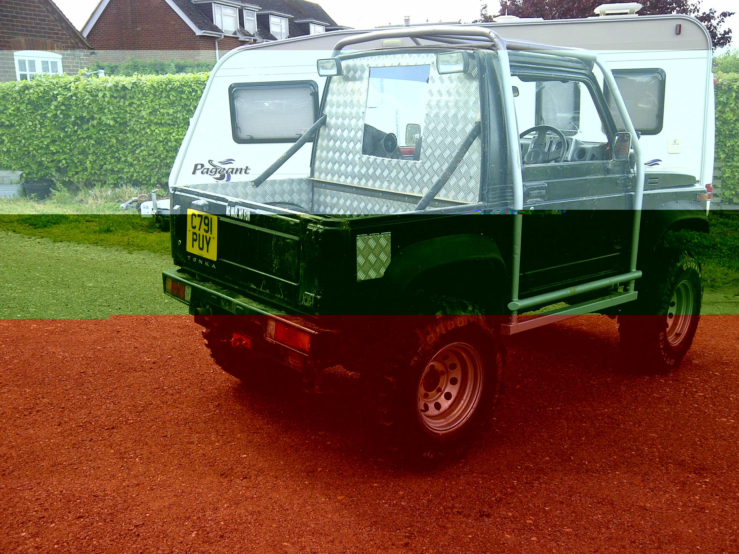

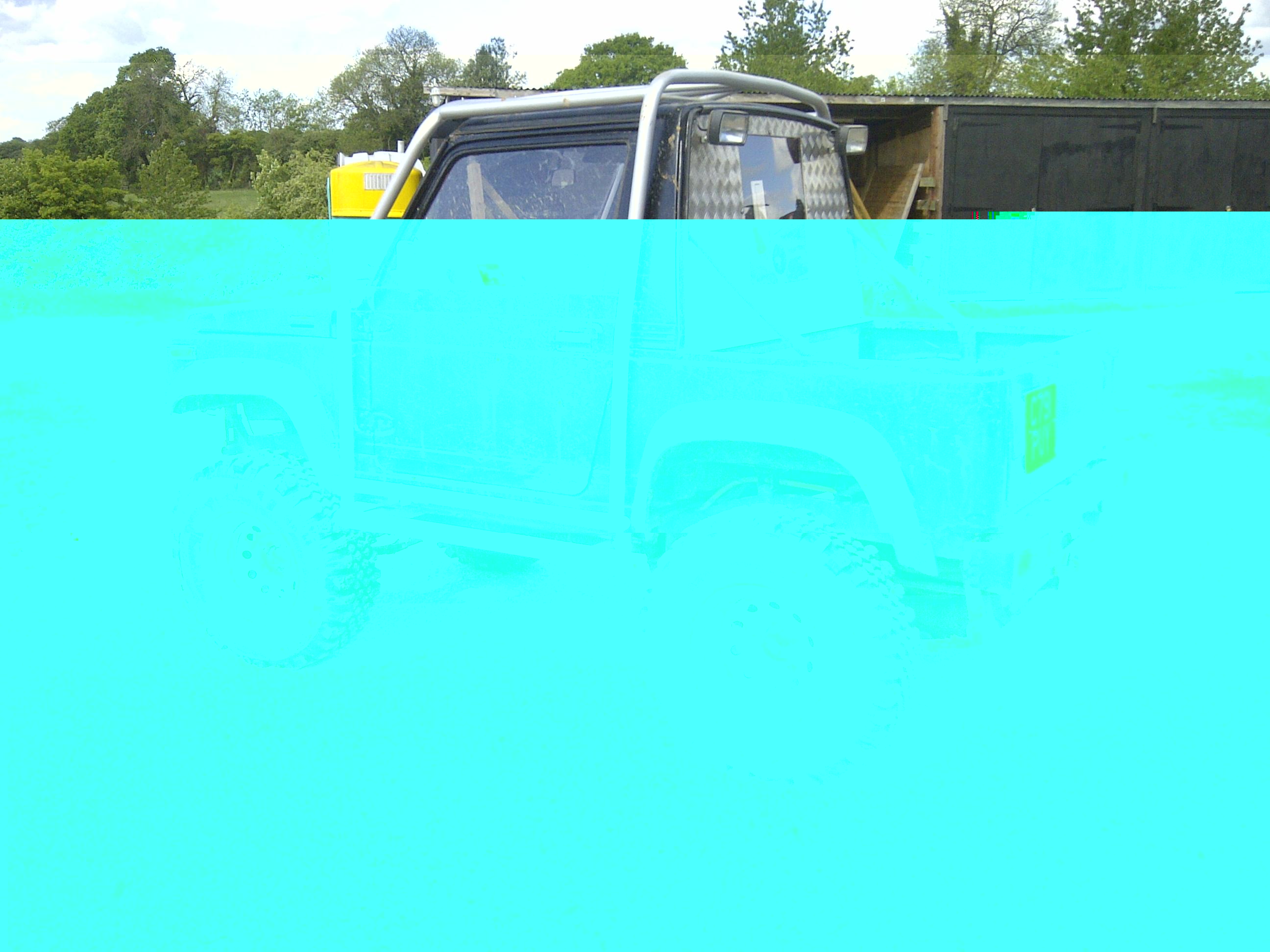

Right finally got round to taking some pics of the SJ so here goes
- and again
- Jeep 1.jpg (716.28 KiB) Viewed 9207 times
- and again
- Jeep 2.jpg (920.77 KiB) Viewed 9207 times
- As it stands now
- Jeep 3.jpg (859.55 KiB) Viewed 9207 times

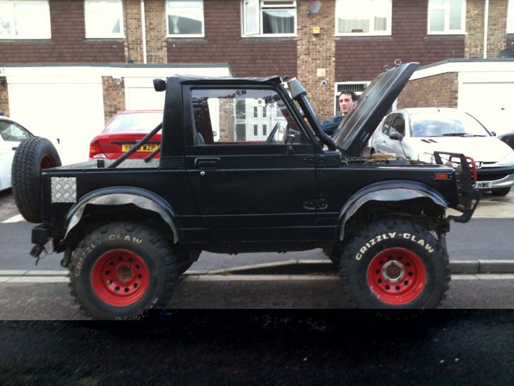

- The day I picked it up
- 71849_441781222010_599242010_5392243_6995286_n[1].jpg (76.17 KiB) Viewed 9207 times
Re: SJ 410 build
Looks cool matey, why'd you swap out the red wheels though? They looked
Re: SJ 410 build
Arnt they just the same wheels with the paint stripped?
