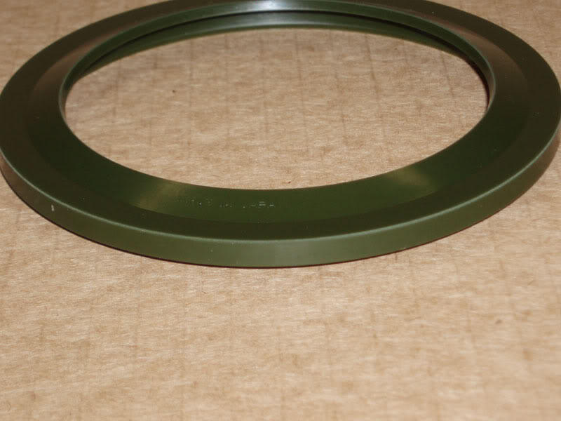

where can i get the seal for the front steering knuckle swivel thingy? :hahaha: (technical term) :hahaha:
i notice whilst i had the truck on the ramp changing the springs that one is missing totally?
its an sj410q
will these come into the mot? as i have it booked for test monday.

no not the T.R.E
the steering swivel hub seal
will try suzuki dealer monday ££££ :snap:
thanks
martin
Re: knuckle seal?
Post by Darrell » Sat May 14, 2011 8:14 pm
This seal.................... 09285-00002
About £12 each last time I heard a price. I would put a new felt on as well though.
