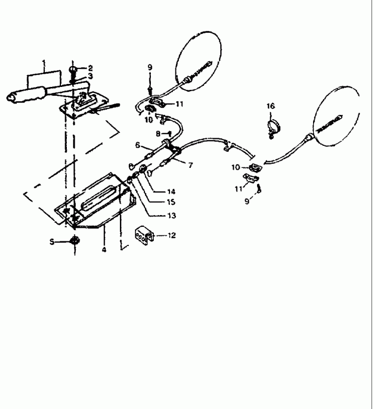

All the diagrams I can find show this setup
O and
O and
- handbrake 1.JPG (128.12 KiB) Viewed 9796 times

Thanks for that, hav'nt got one of those yet, but its not the one,Darrell wrote:All the diagrams I can find show this setup

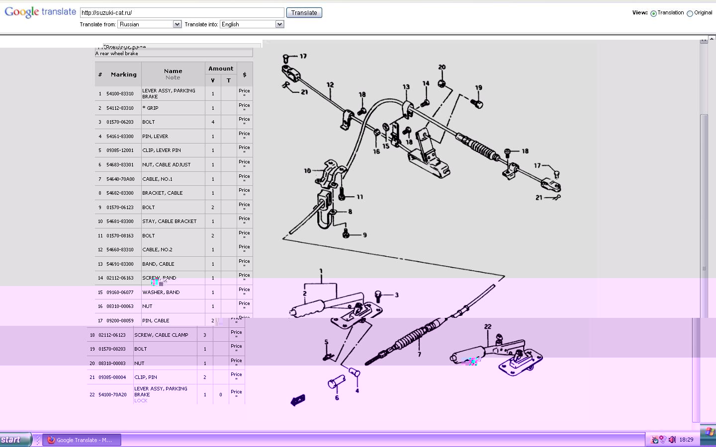

Been hunting again, found this setup fitted to some models. Cables are listed as LH 45096-84c00 RH 45068-84c00
- suzuki-cat.ru.gif (27.45 KiB) Viewed 9784 times

[quote="Darrell"]Been hunting again, found this setup fitted to some models. Cables are listed as LH 45096-84c00 RH 45068-8Thanks,
Thanks, thats the one. I will now be able to show sellers exactly what i want. Can you tell me where they are listed under those no's, Your help is very much apprecited. Rich.
Re: various handbrake cables
From a russian website of all places
http://translate.google.co.uk/translate ... rmd%3Divns" onclick="window.open(this.href);return false;
Don't seem to be able to link to the correct page
So select- samurai sj 413 - modification 49 - suspension/brakes - parking brake
