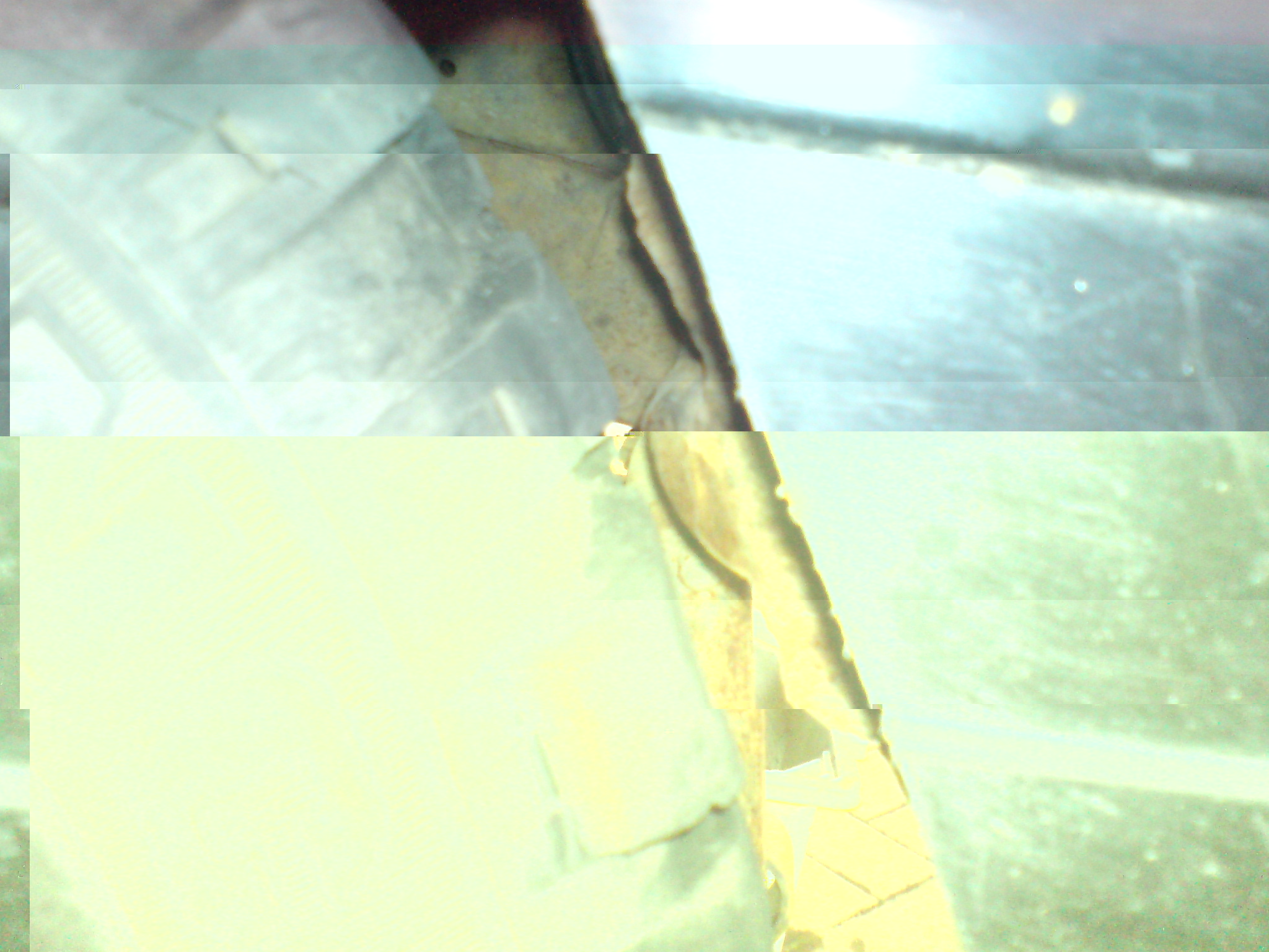

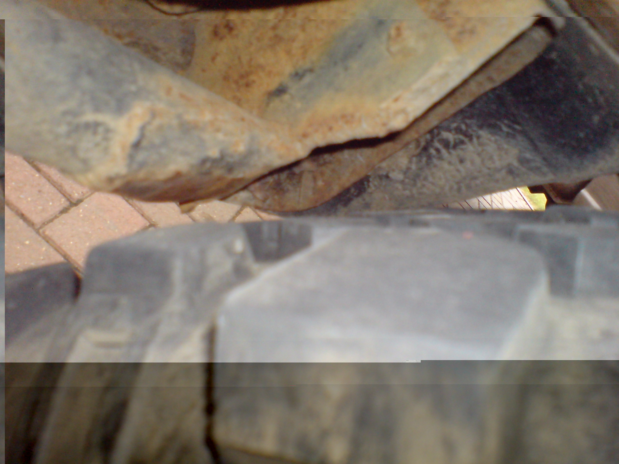

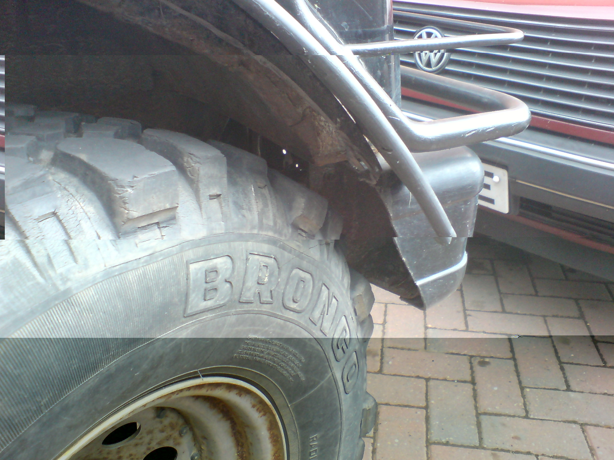

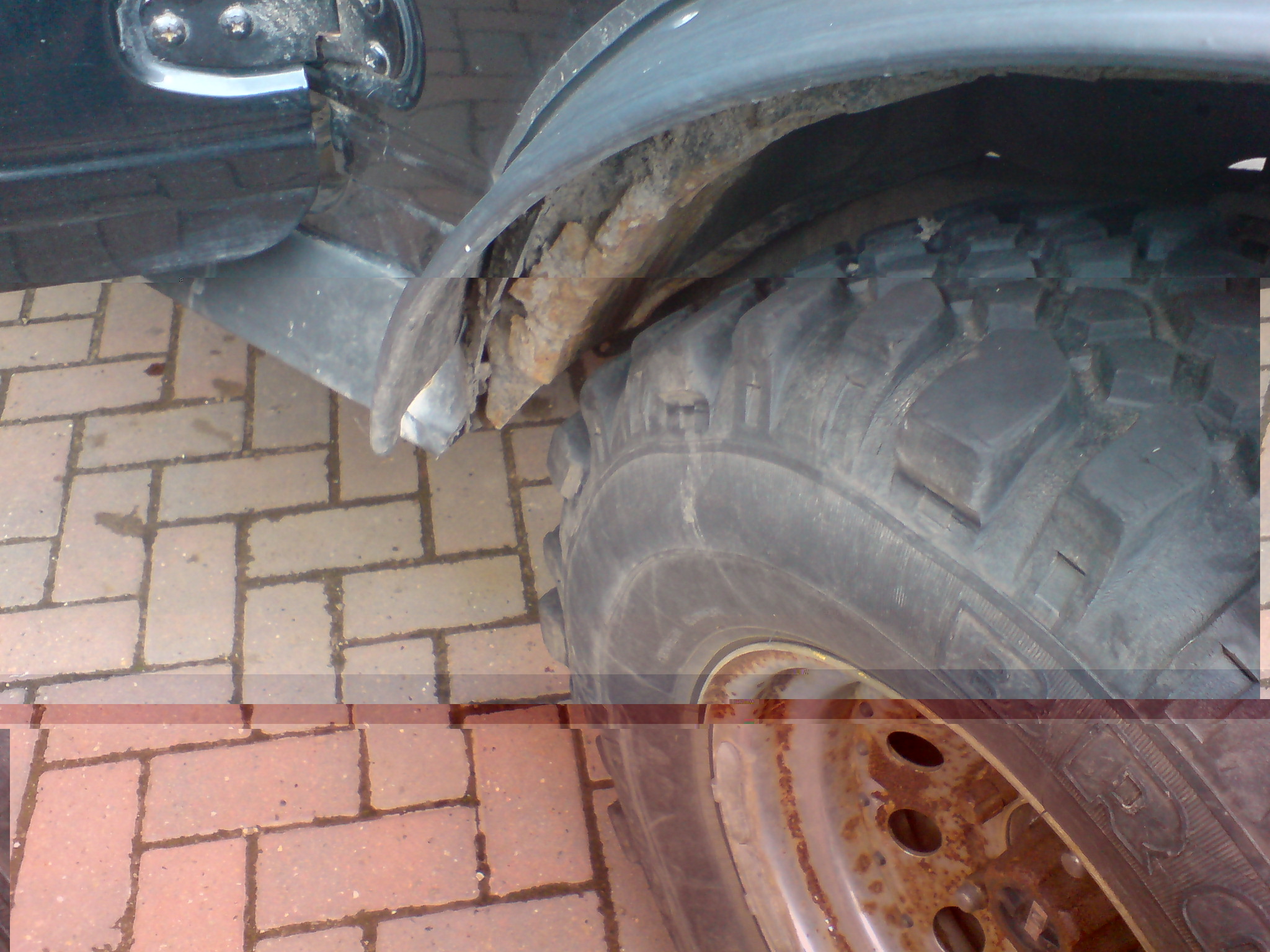

Can you get a picture of the tyres on full lock for us? Cheers
lazy rambler
Posts: 296
Location: Aylsham, Norfolk
Re: Tyre sizes?
Post by lazy rambler » Mon Jun 13, 2011 8:49 pm
In the pics there is a bit of clearance, but while driving on full lock the tyre's rub.
Now a build in progress
Re: Tyre sizes?
Post by twiss » Mon Jun 13, 2011 9:09 pm
Thats quite close. What kind of lift do you have already?
