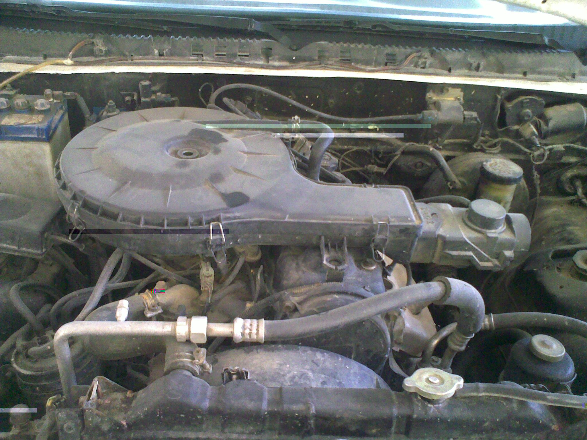

a reducer would be good but i dont have a big distance for the pipe to go
i havent a recent picture with the engine in, but heres where the 1.3 air filter housing is, and i need to connect a pipe to it from the 1.6 top dish thing.

Is it an airbox like this one?
- 13122008004en7.jpg (446.87 KiB) Viewed 7222 times
Re: snorkel
thats it, connecting it to the other air filter box you seen pictured on the right hand side wing.
