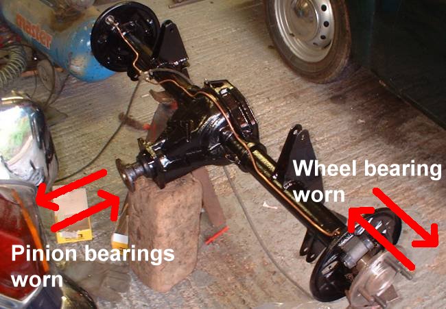

when i jack my truck up and spin the wheels theres alot of play in the rear diff.it moves in and out.whys that?

It means the pinion bearings have failed, it will need to either be rebuilt or replaced.
