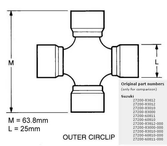

I used to get mine from my local motorist shop, he did have to order them for me though. They were half the price of genuine Suzuki one's. My propshafts are 1986 SJ413 and have the UJ as shown below. These fit the flange that has 8mm bolts, the later models I believe have 10mm bolts and a larger flange diameter (may still use the same UJ ??).
The best way to be sure is to use a vernier caliper to measure what you already have. You don't have to remove the old one to do this.

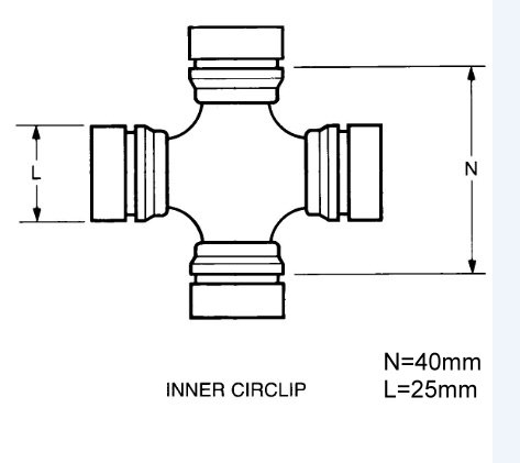

The other UJ that seems to fit on the SJ/Samurai is this one 27200-73813
Inner circlip type.
Anybody have these type ???? Is the size correct ???? only have the info from "Googling" ;)
Inner circlip type.jpg (19.22 KiB) Viewed 4001 times
