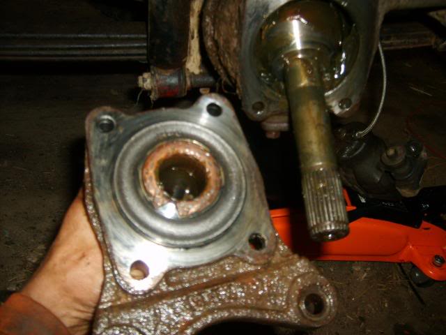

my driver side joint is leaking very fast :lol: typical just after i got my mot aswell , can anyone tell me were to get the correct parts etc and what i need to do i thanks tom...

also i can i pull the felt bit out aswell as thats split aswell so is that a whole cv apart job to do ?
Re: oil seal gone?
Post by Darrell » Mon Jun 25, 2012 9:34 pm
You can get away without pulling the wheel bearing apart. Just undo the 4 bolts and remove the wheel spindle.

Post by turbo-tom » Mon Jun 25, 2012 9:40 pm
Darrell wrote:You can get away without pulling the wheel bearing apart. Just undo the 4 bolts and remove the wheel spindle.
sorry but wheel spindle im confused :er: :oops:
Re: oil seal gone?
Post by Darrell » Mon Jun 25, 2012 9:54 pm
Once the brake disc is off you can remove the 4 bolts and take the spindle off complete.
Some driveshafts will pull straight out exposing the oil seal, but I can't remember which ones :oops:

Post by Darrell » Mon Jun 25, 2012 10:01 pm
I would check for any play on the bearings first, as worn kingpin bearings make the seal leak (although it's just passed an MOT so they should all be good).
