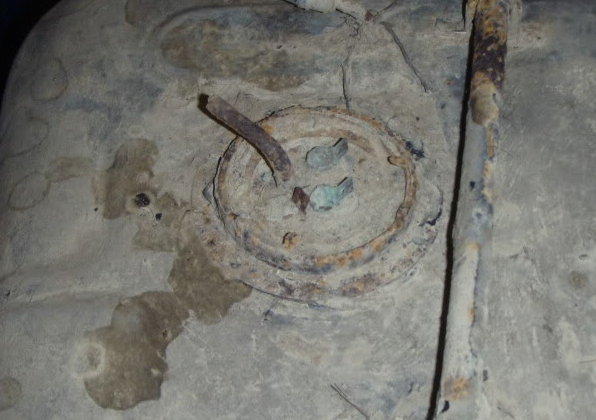

Post by Darrell » Mon Jul 30, 2012 10:53 pm
Mike Harris on here strips quite a few SJ's and may be able to help. I believe that sender type is from the spanish built model.

Post by hamer » Mon Jul 30, 2012 10:58 pm
thats the one mate
mine snapped quarter inch from the bottom :(
if it snapped that high up i could have repaired with rubber pipe and clamps im gutted :(
