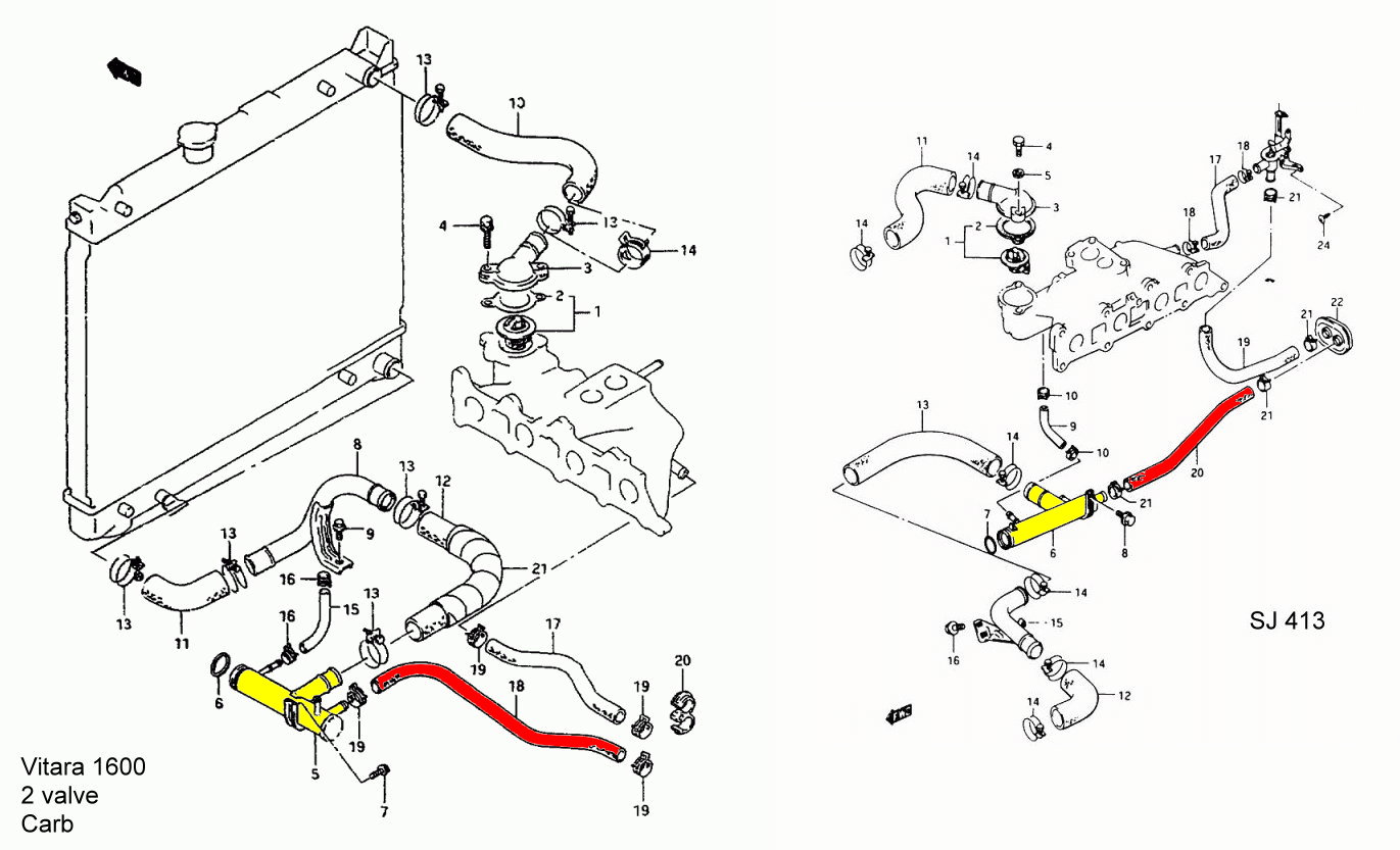

Just a query just bought a SJ that is in bits I have starter to rebuild and I have a wiring issue that I think is now resolved from your forums.
The SJ is a 1986 1300 with a 8V 1600 Vitara engine.
Water hoses that leave car go straight onto engine not into the heater adjust valve which way should they go has anyone got any pics of the way they should go.
Thaks in advance
Mike
Re: Heater/Water Pipes
Post by Darrell » Sun Oct 14, 2012 9:19 pm
Hopefully this will help. The layout is much the same but the heater return pipe goes on the side of the 1600 water rail unlike the SJ413 which goes on the end.
