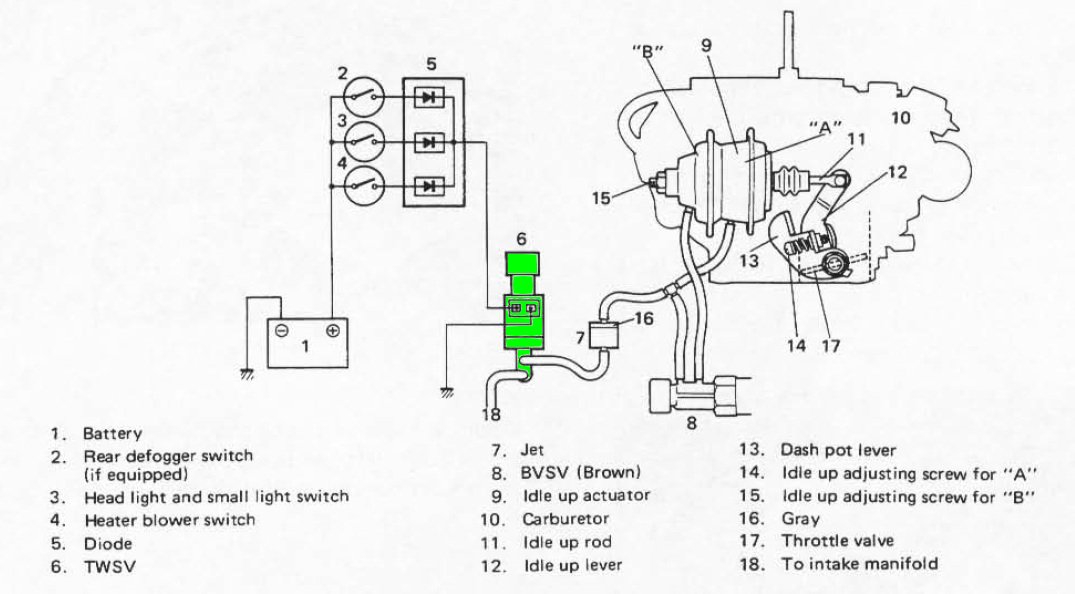

Idle up valve.jpg (81.41 KiB) Viewed 5304 times

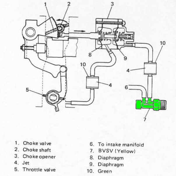

Choke opener valve.jpg (51.66 KiB) Viewed 5304 times
Both only used with the standard carb.....
