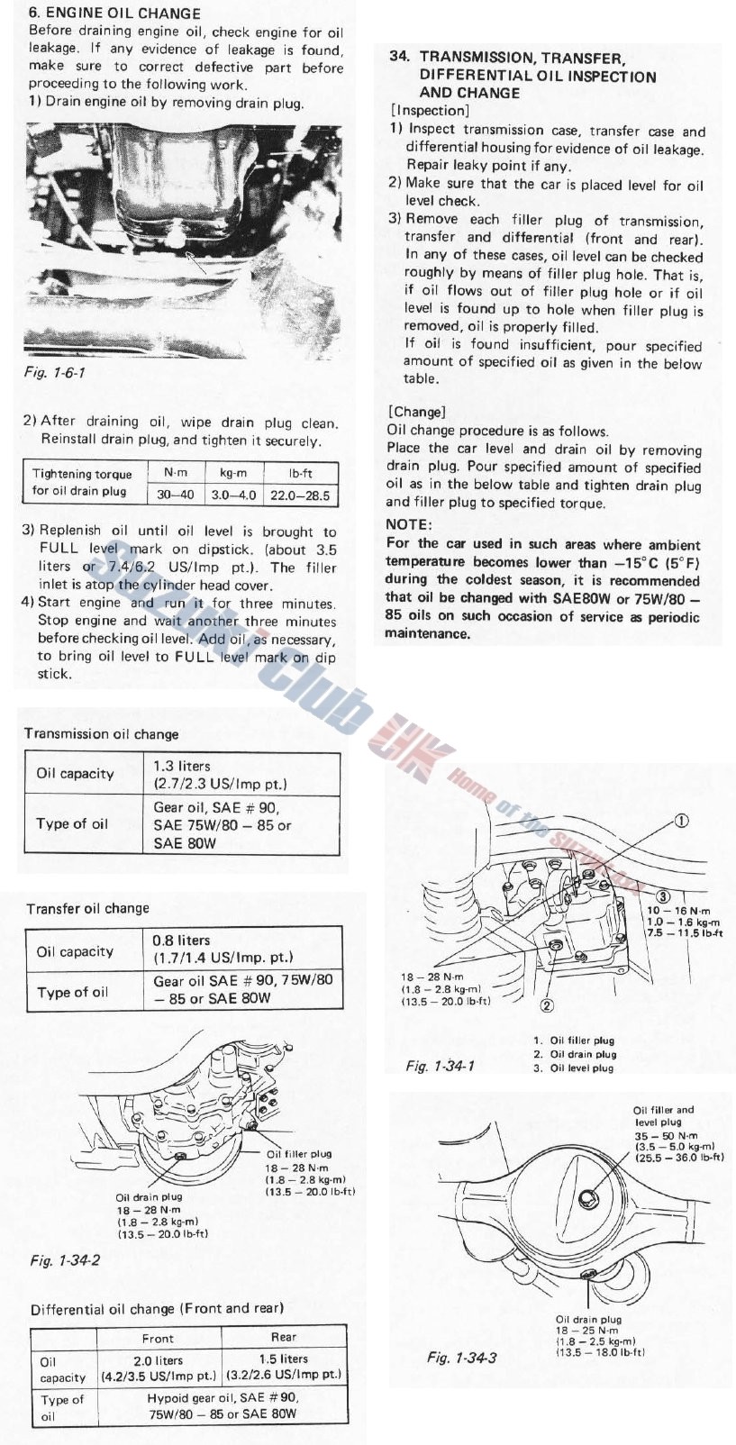

Re: best oil
Post by Darrell » Sat Dec 01, 2012 2:58 pm
Thought I'd posted this before but couldn't find it :er:
So I've re-done it :thumbup:
Oil changes SJ413.jpg (352.11 KiB) Viewed 7206 times
