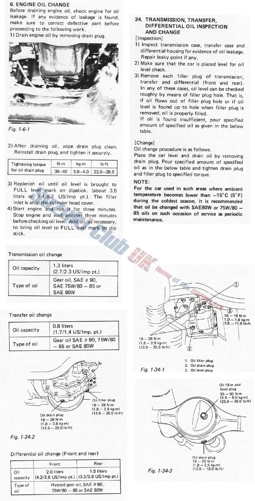

In simple terms what oils are required for GEARBOX,TRANSFER BOX AND FRONT & REAR AXLES,Local motor shop says it is the same in all is this right ???
Also how much is required ???
Many Thanks

Same in all. And i've just changed mine and i'm damned if i can remember the grade.

Post by Jordi » Mon Dec 10, 2012 9:24 pm
Here it is

Post by Darrell » Mon Dec 10, 2012 9:27 pm
:suzuki:
Oil changes SJ413.jpg (352.11 KiB) Viewed 3975 times
