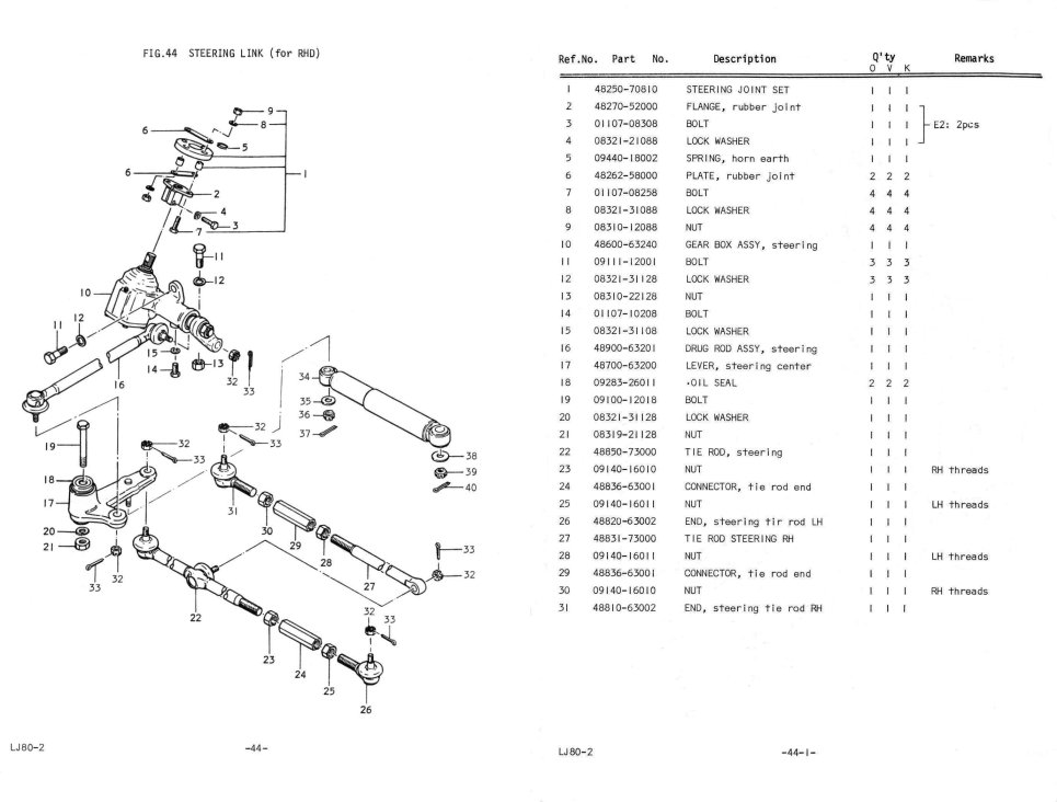

If you guys mean part 17 I bet Mr Rockwatt could machine a bush to fit it. What material is it as standard? as I see it has seals on it.
- lj.jpg (89.81 KiB) Viewed 11138 times
Re: Wanted LJ80 - Steering tie rod lever
Yep, number 17 it is.
I think the original material was (now past tense) rubber with a metal insert(?). I heard people mention rebushing it with brass, which sounds like a great idea. I just need to find a fabricator in the Basingstoke area.
Um, anyone??
