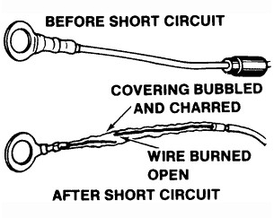

Post by Darrell » Sat Dec 22, 2012 10:06 pm
Another diagram.

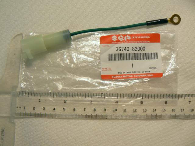

Fuse link wire.jpg (79.27 KiB) Viewed 56657 times

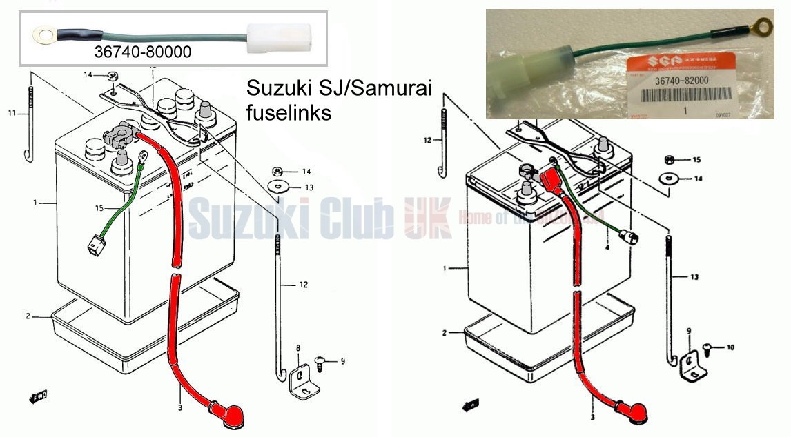

Suzuki SJ samurai fuselinks.jpg (135.81 KiB) Viewed 56654 times

I know a few of you have replaced these with larger wire and fuse holder/fuse.
I've seen 30 or 40 amp used.
Feel free to add any info on what you have done :thumbup: .

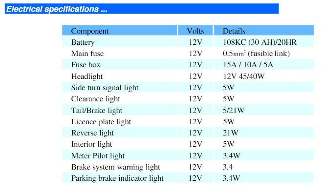

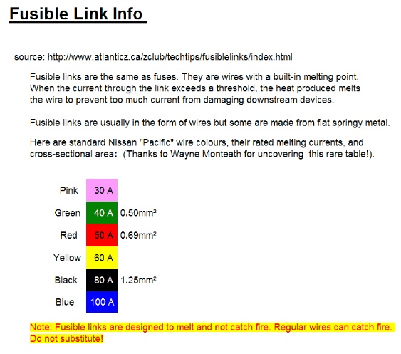

According to the tinternet the green is 0.5mm and rated at 13amp continuous and 40 amp blow.
Seems low to me if you had the heater fan - lights - wipers etc on must be near the limit ?
I would think a fuselink is much slower blowing than a standard blade fuse so could take a little overloading for some time before it melted. However a dead short would melt it in seconds :thumbup:
I dunno :er:

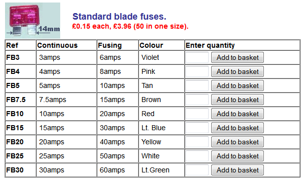

Here's some normal blade fuse info anyway.

Thanks for the input guys. I see most standard blade fuses only go to 30amp but a few people sell 35 and 40 amp ones. I also see most blade fuse holders are only rated at 30 amps but again if you shop around you can find 40amp ones. Alternatively a "Maxi " blade fuse and holder could be used.
