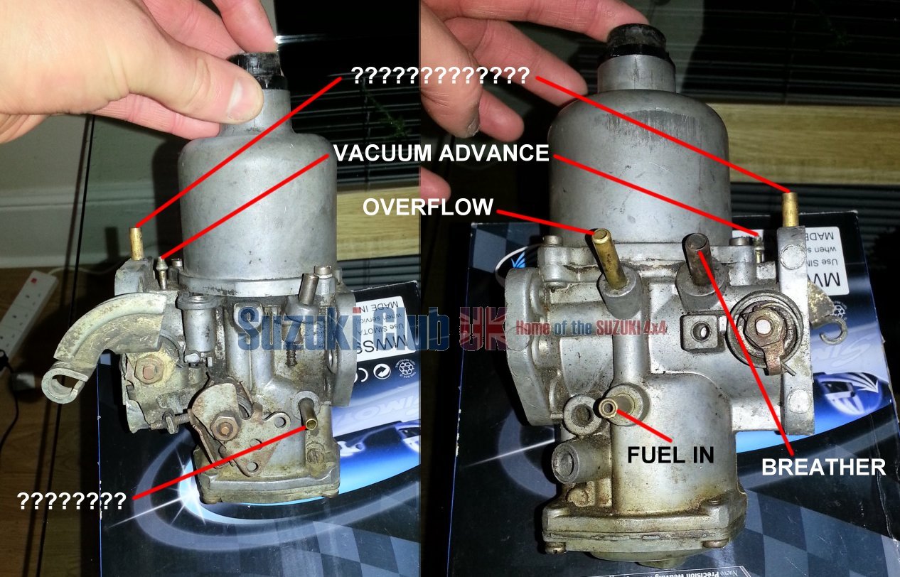

hi guys i have read the sticky on su carbs very helpful i have replaced the needle and spring and now im pretty much set but dont know what hoses go where so could any one guide me in the right directions from the pics below??

Going off the top picture.
Top right is a breather pipe. Block it.
Top left is fuel overflow. Most people run a pipe off this down to bottom of engine bay. Doesnt normally overflow unless you are having cab probs.
Bottom left is fuel in.

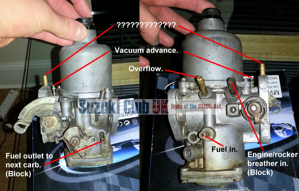

Added Jordi's info. :thumbup:

Guess the one next to the vac advance is another one but just the opposite side of the butterfly. Block it.
The bottom one with all the ??????? I would guess could be fuel outlet for a twin carb setup. Try block the overflow and blow in the fuel in pipe and see what happens. If it is then block it....... very well!!!

Dan your probably correct :thumbup:
So......................
Re: su carb help i have read the sticky
Post by Edweird » Thu Dec 27, 2012 7:51 pm
Ah, so it looks like it's the left handed carb from a twin-carb pair.
