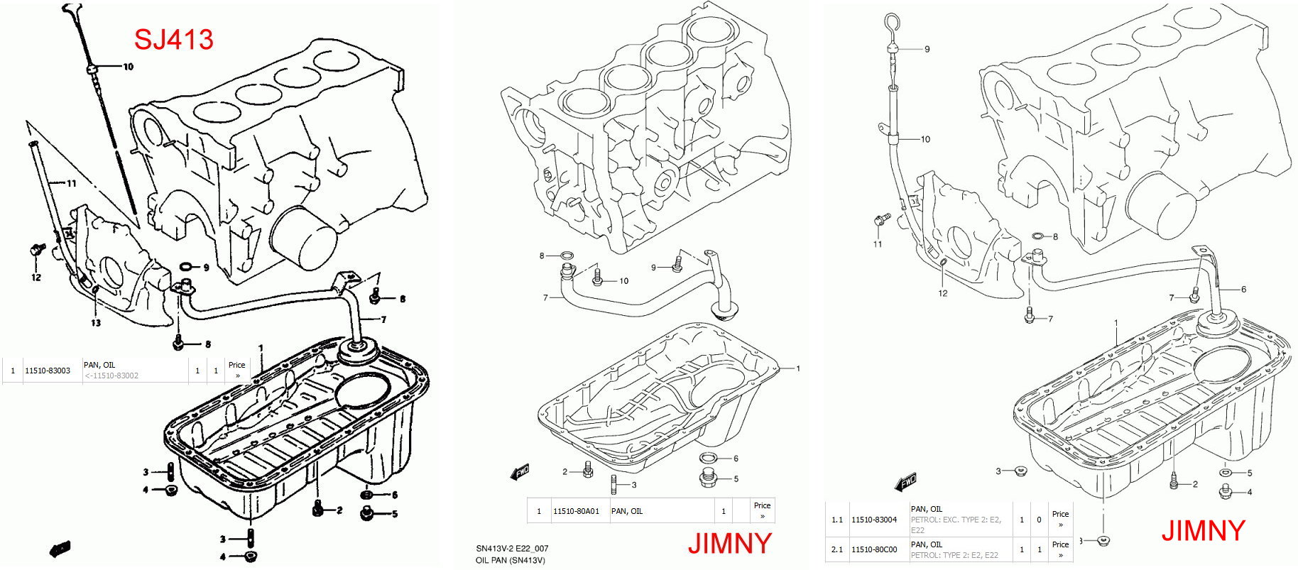

does anyone know if the sump pan from the SJ 1.3 will fit a Jimny 1.3?

With the info I can find the same pan is fitted to the following
G13a engine 86-89 SJ samurai Carb
G13ba engine 90-95 SJ samurai SPI
G13bb engine 98-2004 Jimny 16v MPI
Later Jimny's use the M engine.
When searching for part 11510-83003 some sites said superseded by 11510-83004
In the diagram they look identical ??
Only what I've found on the net so can't guarantee it.

If the Jimny is fitted with a G13 then yes it should be pretty much the same sump, there might be minor differences though.
If the second half of the Part number starts with 83... then it means that part was first used on a Suzuki SJ413
The last 3 digits are variotions of the original part, so 11510-83004 would be the 4th version of the same basic sump.
