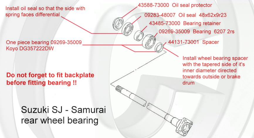

I would wait for some more opinions but to me it's bent like that because the retainer plate is not sitting flush with the drum backplate. I can't think what could cause this. :er: :er:
Rear wheel bearing diagram.jpg (365.94 KiB) Viewed 4136 times
However my backplate is the retainer so I may be talking s**t.
Just thinking out loud really :thumbup:
