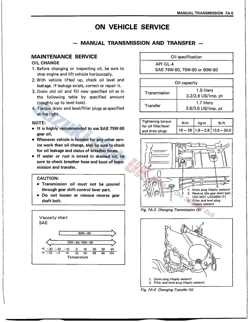

anybody know gbox and t box grades and capacitys
Post by ali » Wed Mar 13, 2013 9:04 pm
any body know these i'm ready to throw another box in ?? :S oops its a vitara 1.6
and i took about a gallon out the gbox and 2 litre out the t box lol and none of it oil :bawling:

Sae 75w90 gl4 or equivalent yellow metal safe oil in the gearbox
1.5l I think
Sae 75w90 gl5 in the transfer box or equivelent hypoid gear oil.
1.7l I think
The weights don't really need to be those exact ones say 80w90 etc will be fine, the main thing is that you use GL4 or a yellow metal safe oil in the grarbox.
Re: anybody know gbox and t box grades and capacitys
Post by Darrell » Wed Mar 13, 2013 10:05 pm
:suzuki:
vit transmission transfer oil.jpg (218.13 KiB) Viewed 5501 times

cheers for that guys! :doublethumbs:
