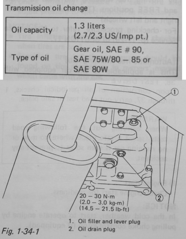

Post by Darrell » Sun Mar 17, 2013 8:49 am
Gearbox oil level.jpg (65.14 KiB) Viewed 5704 times

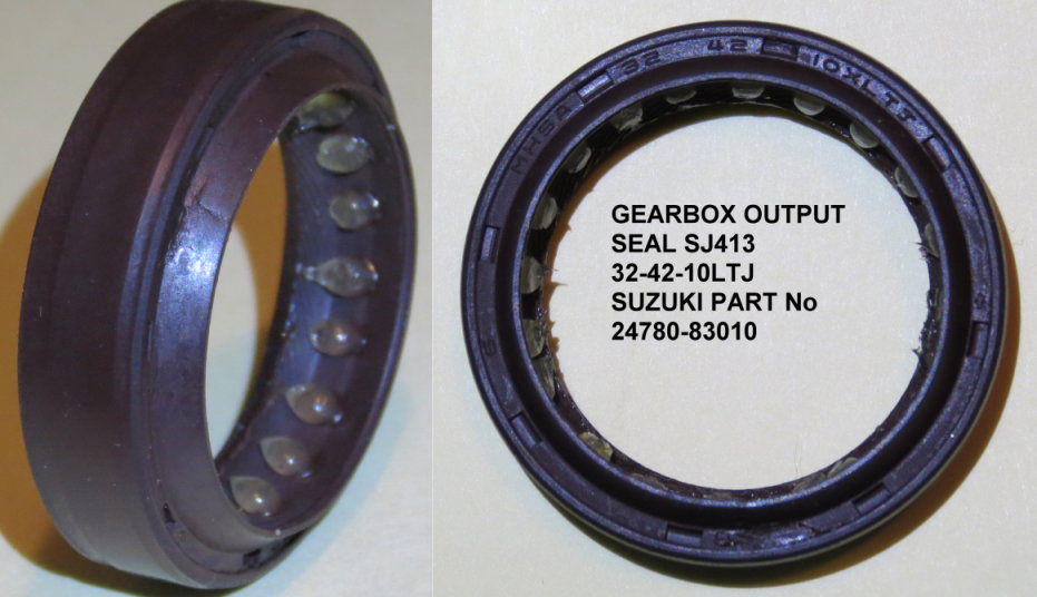

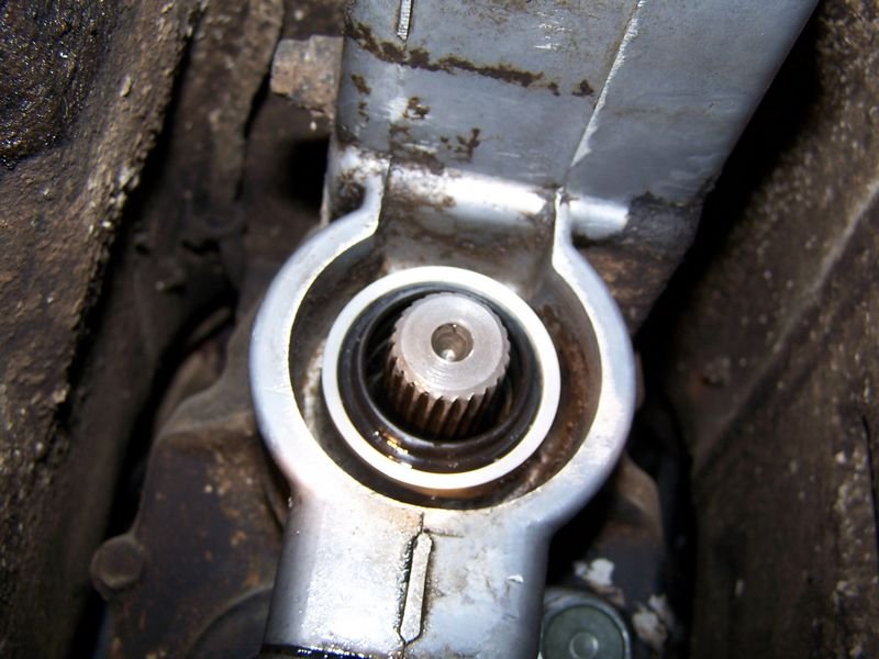

Gearbox output seal.jpg (81.33 KiB) Viewed 5704 times
The seal can be replaced with a 32-42-8 r23 seal which any bearing supplier should have.

Will do that. Are they all the same oil, 80w90? Thanks guys

Re: Sticky 1st gear
Post by dan_2k_uk » Sun Mar 17, 2013 12:21 pm
Theres loads of info in the tech spec section of the homepage :thumbup:
