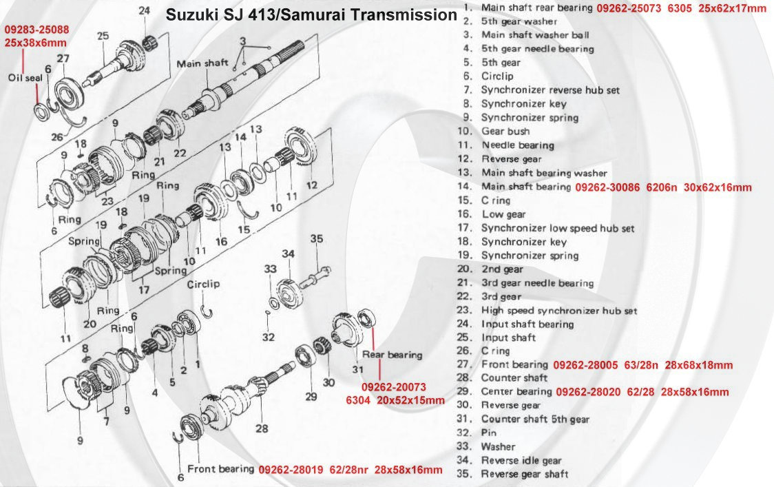

Any help http://www.geerdijk.com/files/suzuki/tranny_rebuild.pdf
Not sure if I've posted this before as nobody has ever confirmed if all my info is correct
and I've never rebuilt one..
- Transmission.JPG (165.86 KiB) Viewed 4101 times
