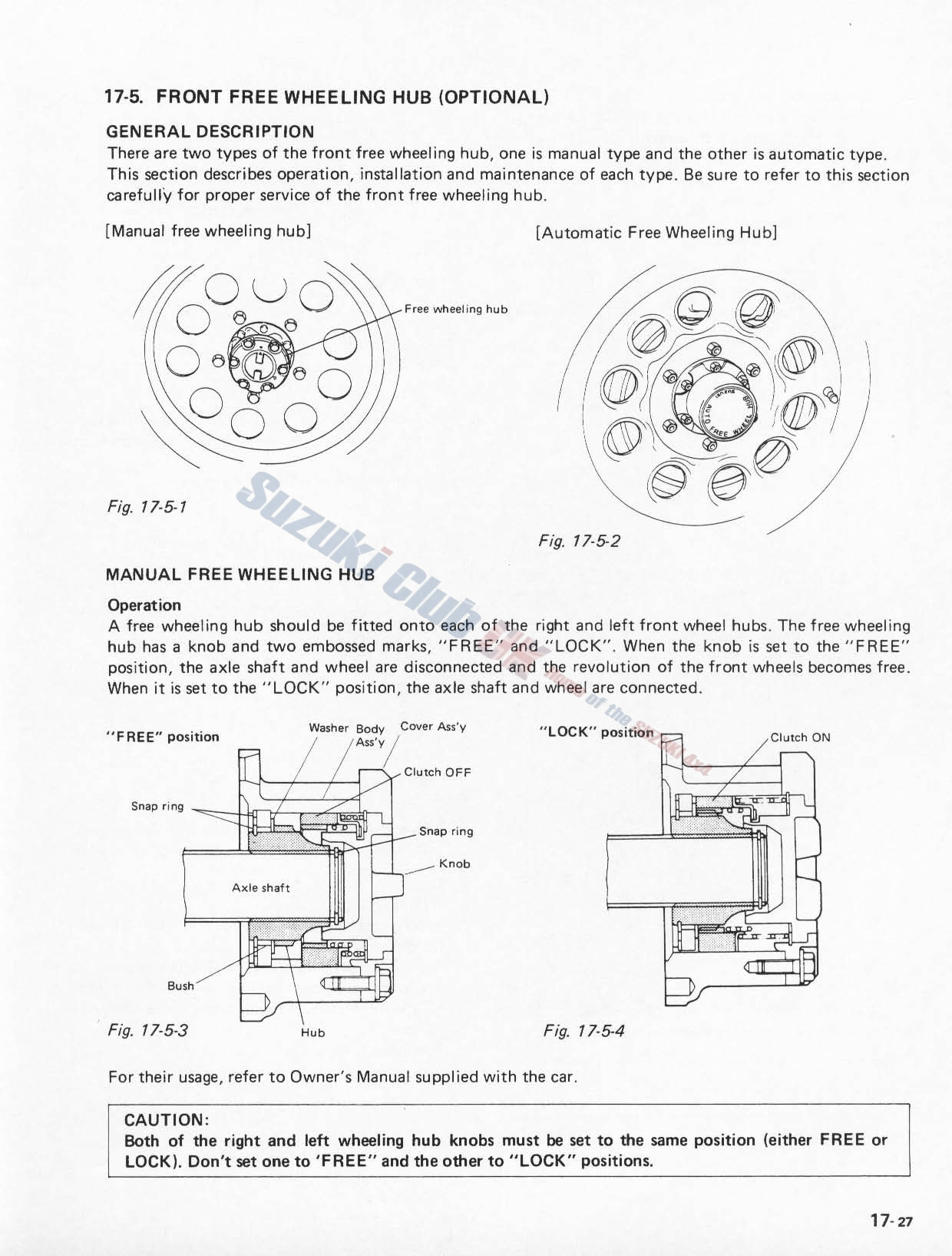

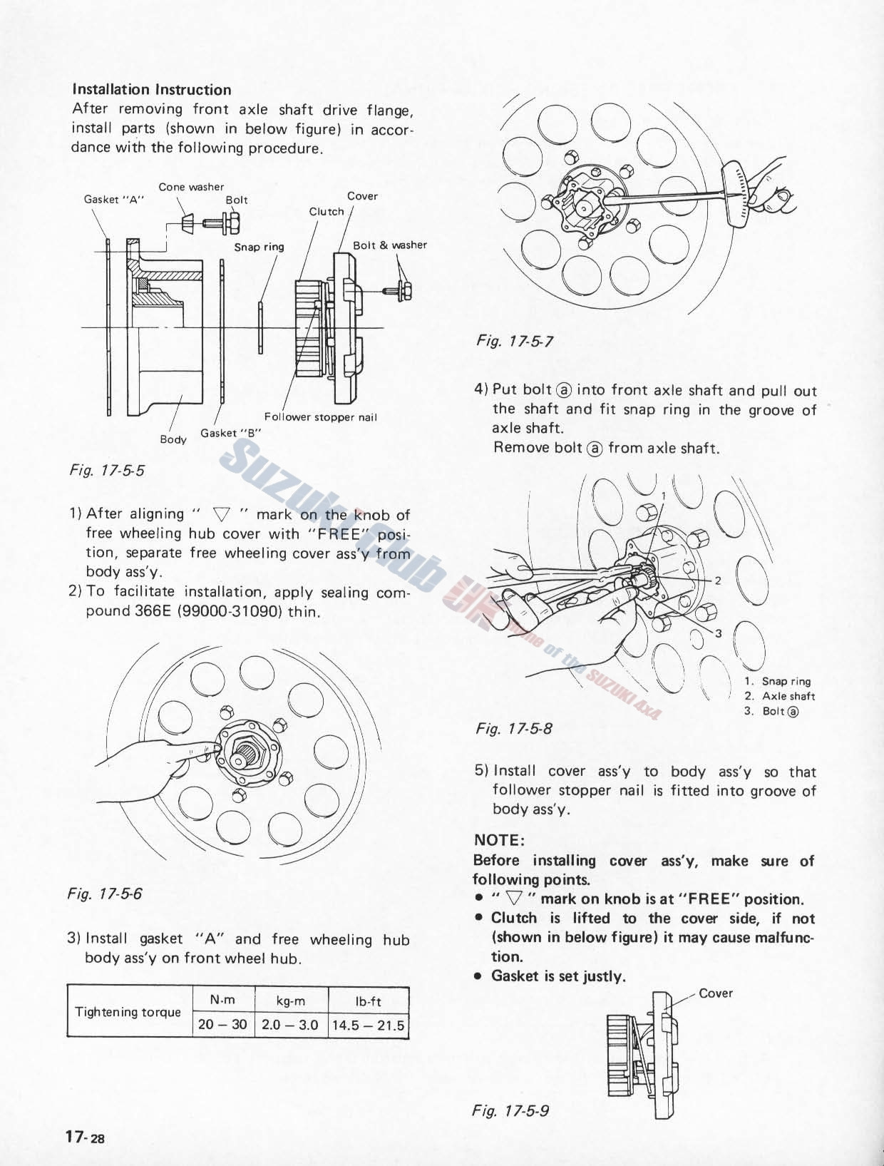

Hi all
Been serviceing my hubs and CV's, found my drive shaft seal had popped out! Have also noticed that there is no circlip at the outer end of the shaft stub. I have free wheelin hubs, should there be circlips? :er:

Yes.. :thumbup:

Thankyou Darrell, I will pinch them off my donor anus!
