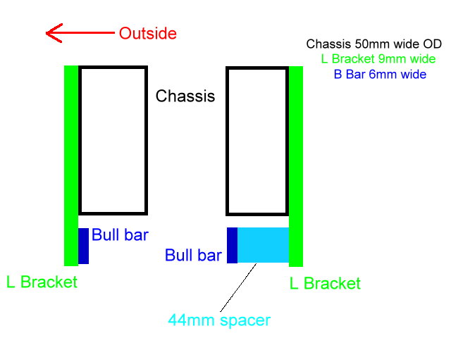

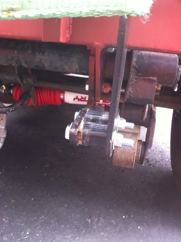

I can't find any different brackets for the Samurai.
I have no idea if there are different bars for different models.
Only found one photo of somebody's modified bracket.
To me it just needs spacing out with whatever suitable steel you have available.
There not very strong anyway so I don't really see a spacer weakening things.
Either that or cut them off and weld some flat bar in to step them over ??

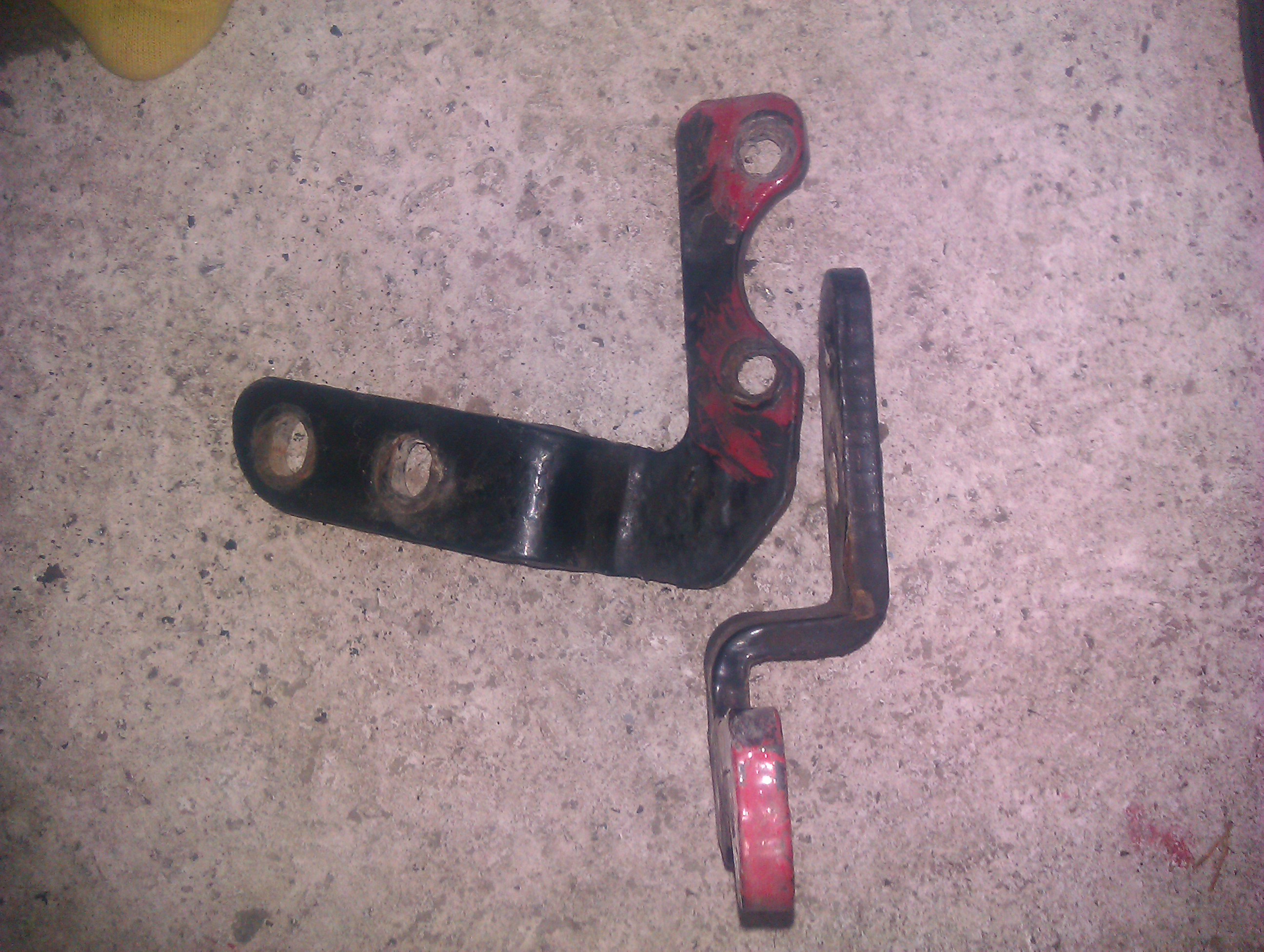

The bull bar brackets are different, the samurai ones are bent to mount on the inside of the chassis rails, kind've like the ones in the picture that darrell posted but just bent up out of one piece of plate. some also have different bolt hole spacing so you need to drill out the mounts to fit the other type, I found this out when I went to fit the bull bars off my LWB samurai onto karis's SJ410

ive never seen the special brackets that are bent, any idea where i could get a pair? if not it looks like i will need to get the welder out and follow darrells diagrams.

This sort? I have a spare set (these are from borneyo - Dan bornes Sammy) £5 plus postage?

Do you know how long I spent Googling trying to find a photo or diagram of those :argh: :argh: :argh:
Blooming ages :bawling: :bawling:
Thanks :thumbup: , it's the first time I've ever seen any :thumbup:
