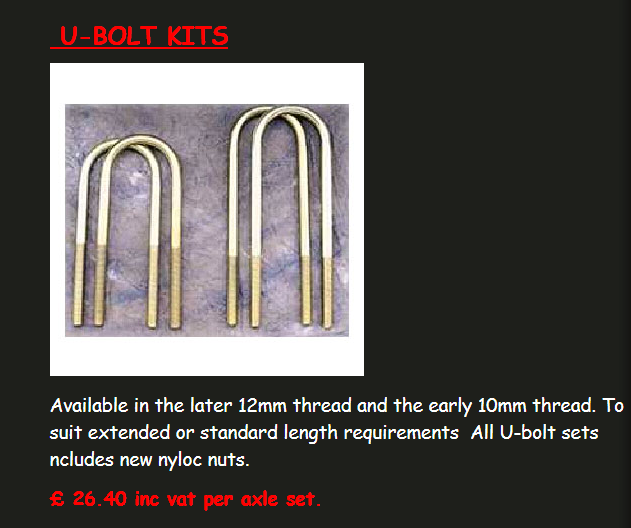

Post by Darrell » Sun Apr 21, 2013 2:23 pm
Dave at http://www.llama4x4.com/page5.htm has a good reputation :thumbup:
u bolts.png (183.62 KiB) Viewed 6582 times
Re: Wobble truck...
Post by Edweird » Sun Apr 21, 2013 4:10 pm
Darrell wrote:Dave at http://www.llama4x4.com/page5.htm has a good reputation :thumbup:
I got my U-bolts from there. Friendly bunch. Had them in the post right quick.
One thing I might point out which I rang back about and had explained to me:
If you get a full set of U-bolts, you should find that there are two of them that have a larger radius curve on them. These two bigger ones are for the front axle on the side nearest the diff.
