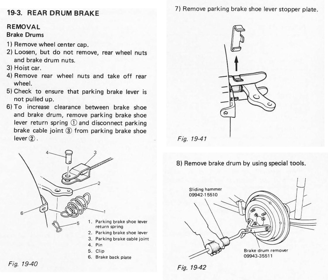

Hi all, just wondering if I could pick some of your brains. I'm trying to get the rear brake drums off but they don't seem to want to budge. After the four central bolts have been removed is there anything else needed to come off ? There are a set of screws all around the edge, do these need to come off as well ? Thanks in advance.

put the wheel bolts on back to front, and hook a hammer behind these, and lever on top of the four bolts, and work your way around, but be carefull to not reck the threads on the studs. just work your way around, and use a bit of force, should come off, worked for me at least

Or ;)
Drum 1.jpg (166.53 KiB) Viewed 6381 times

Put the wheel back on and bray the back of it with a hammer.
There will be a lip on the the edge of the drum catching the shoes most likely. If it hasn't been off in a while it will have seized to the studs too.

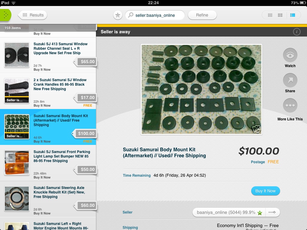

eBay.com
Put in body mount samurai
Look for a listing by baniyanaonline or mantra4x4
It's an company in India making reproduction suzuki parts, that where I got mine from. When they tuned up though they where genuine !!

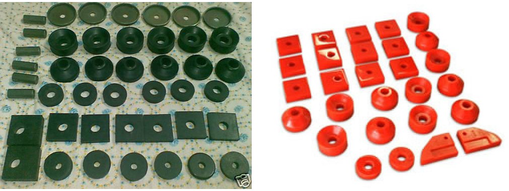

Or in the UK
http://www.mountaingoatperformance.eu/s ... j-413.html
You get quite a bit more for less on fleabay
Body mount bushes SJ.jpg (91.09 KiB) Viewed 6343 times

Spidertrax one doesn't come with the colours or the washers though I don't think?
