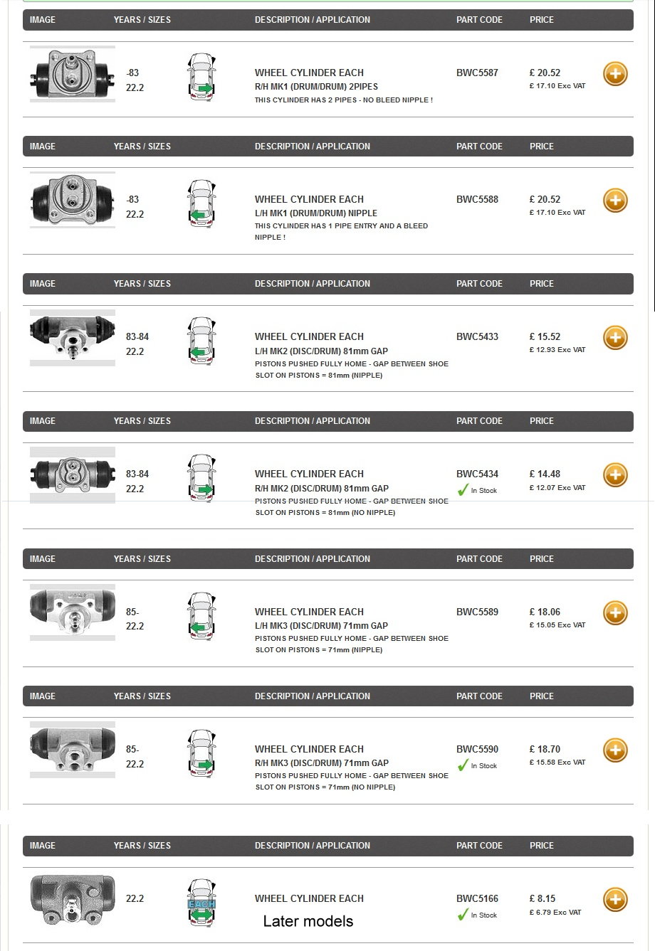

All my diagrams show the pipes going to one cylinder then across to the other. IE pipe in-out and pipe in-bleed nipple.
However when searching for cylinders it showed the later model 410 using only one type. IE pipe in-bleed nipple. So assume this has a "Tee" fitted.
I would establish exactly what you have fitted now before ordering.

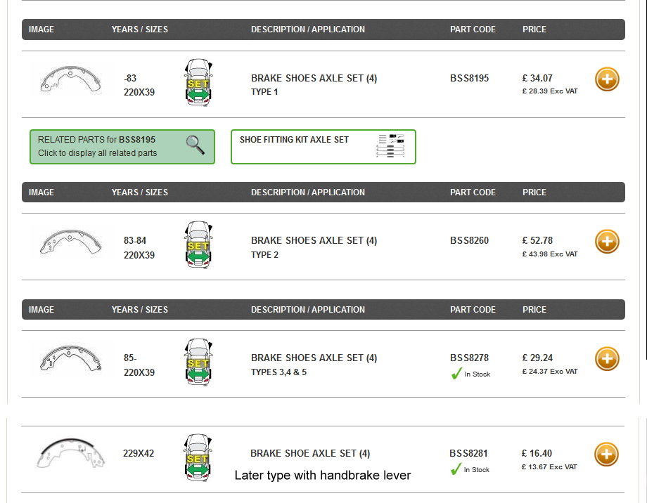

I also believe the shoes with the handbrake lever are also slightly larger than the ones without.
Best you get the tape measure out :thumbup:

Seems like you have a later model 410 back axle by the sounds of it. According to the brakes website the handbrake on the rear drums was 1987 onwards (E reg>)
Nicked the shoe info now :thumbup:
