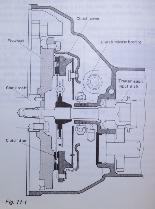

Post by Darrell » Sat May 25, 2013 5:41 pm
Better late than never..
Early 410 clutch
Early 410 clutch.jpg (83.34 KiB) Viewed 4337 times

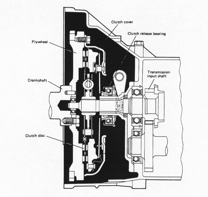

Later 410 clutch
410 later clutch.png (425.93 KiB) Viewed 4337 times
ojr1979
Posts: 78
Joined: Fri Feb 08, 2013 8:22 pm
Re: sj410 clutch disc
Post by ojr1979 » Sat May 25, 2013 6:38 pm
Pokey out side towards gearbox cheers darrell!
