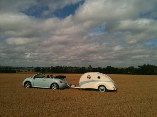

sounds interesting are you thinking mini aero style van like this, would be good to see a build thread.
the problem with caravans is the aerodynamics i regularly tow with my sj it is a 1.5td conversion and will easily pull 1.5ton car on an a frame but i once tried to tow a friends horse box and on the local bypass was flat out at 40mph and it didn't take long befor my temp was getting near the red
- teardrop caravan.jpg (30.38 KiB) Viewed 9161 times
