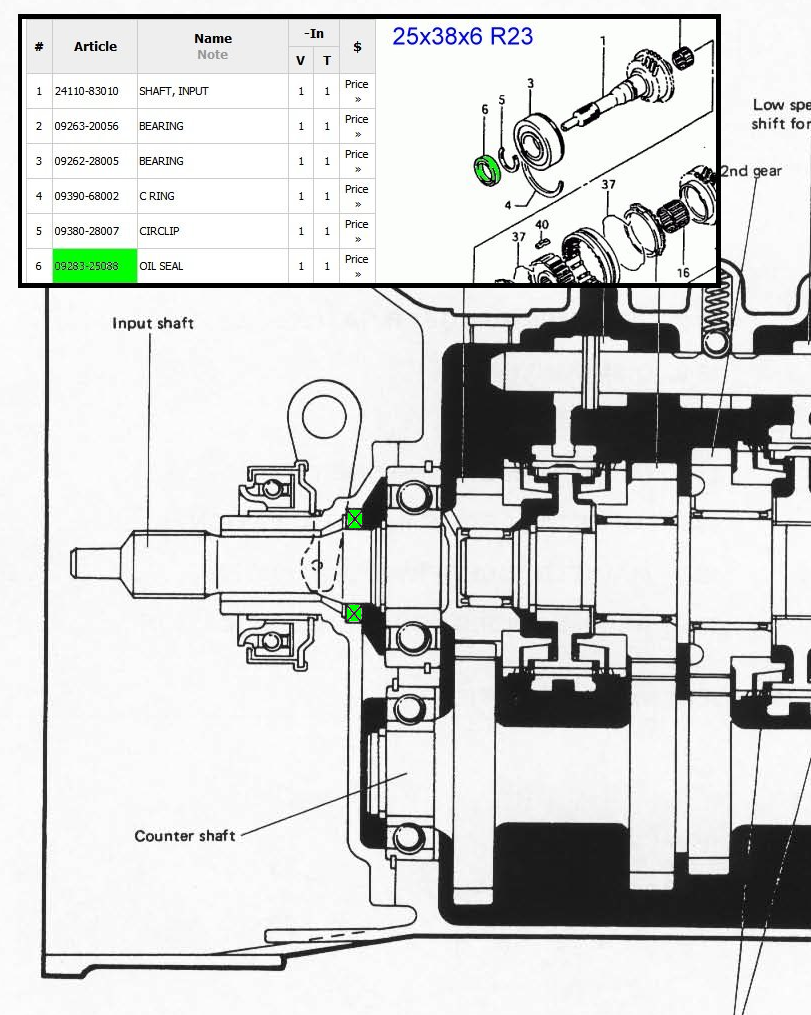

Post by Jordi » Sun Jun 30, 2013 4:14 pm
How much? Where from? How to do it!!!!
Help urgently required!!!!!
Presuming thats what it is as the oil is coming out the bottom of the bell housing

Post by dan_2k_uk » Sun Jun 30, 2013 6:30 pm
Jordi wrote:Stop leak in the gearbox?
Just thickens the oil to slow it down.
I guess you can just take that from cover off to replace the oil seal but then you will need a gasket for that too.

According to the tinternet.......................A 413 / samurai has...............

I am right in thinking its just take the cover off behind the release bearing. Swap seal & refit?
