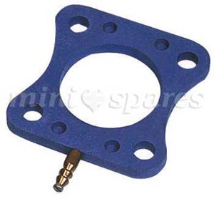

You can get these jobbies............

Darrel those plates put the vac takeoff on the wrong side of the butterfly for an SJs vac advance set up.

"Darrel those plates put the vac takeoff on the wrong side of the butterfly for an SJs vac advance set up." My Bad
What are they good for then

The work well on minis!!! I was looking for something like that for ages that would fit inbetween the carb and air hose/box connector... but apparently it wont work correctly if its on the wrong side of the piston :(
