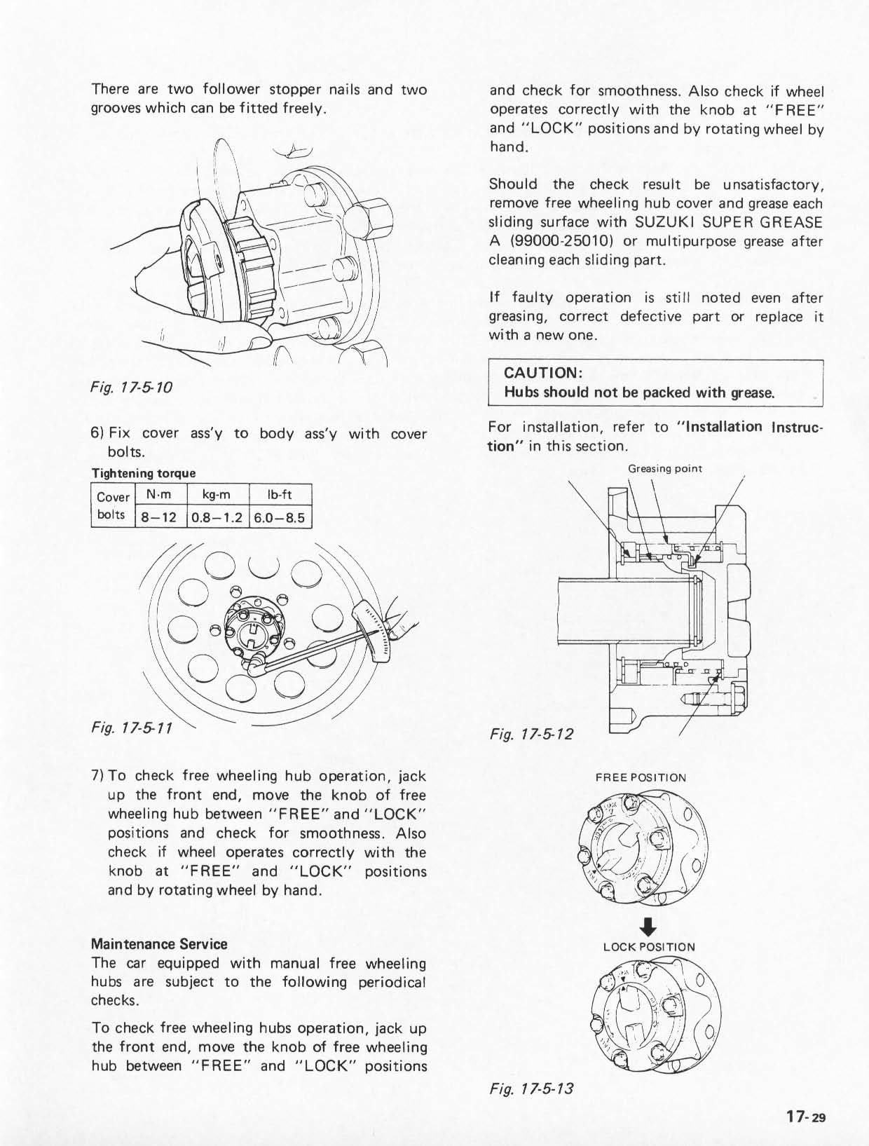

Multi-purpose grease is fine. No you don't need that moly grease.
If there in reasonable condition you won't need to strip them down completely, just a light clean and regrease. They don't want packing with grease either, just a little over everything.

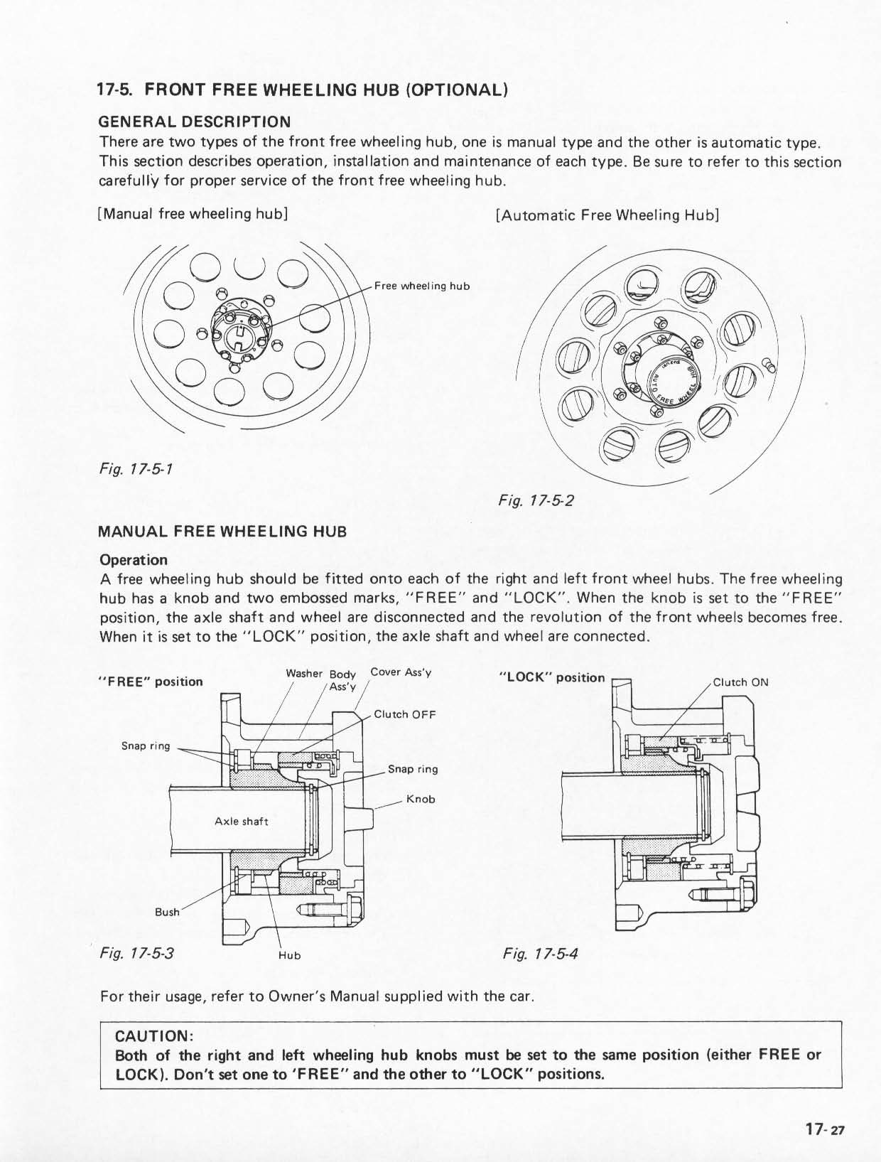

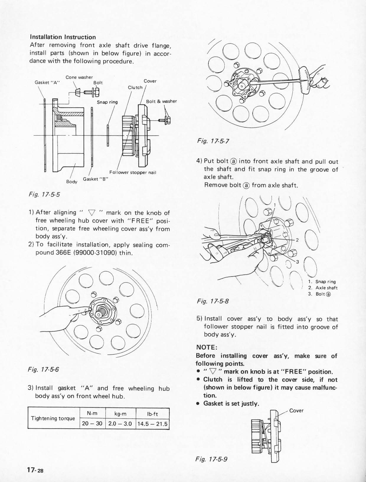

Below is just from the workshop manual, but as you said there are plenty of write-up's out there.

- fwh3.jpg (336.53 KiB) Viewed 3143 times
- fwh2.jpg (313.54 KiB) Viewed 3143 times
- fwh1.jpg (319.92 KiB) Viewed 3143 times
