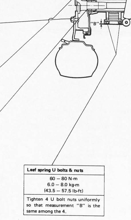

Re: U bolt thread
Post by Darrell » Sat Sep 14, 2013 10:54 pm
This is for m12 bolts
