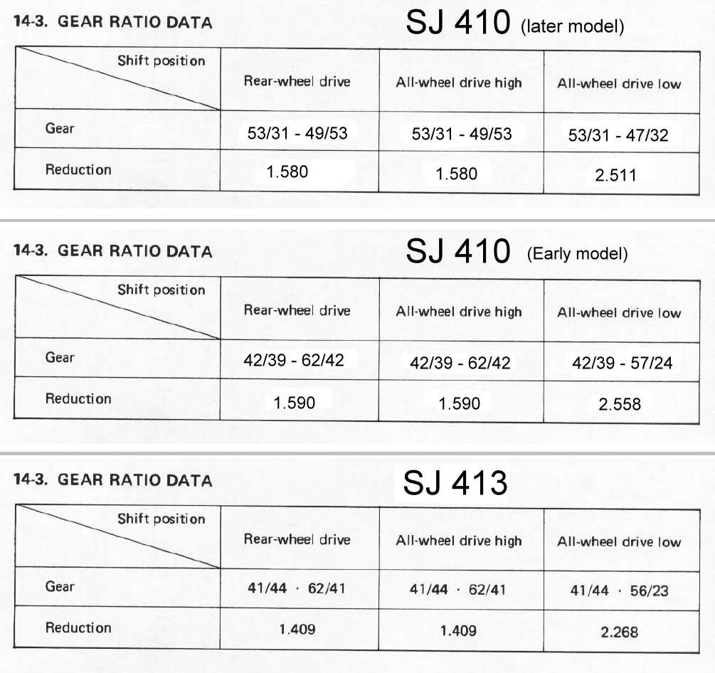

Does anyone know how to tell the difference between a 410 and a 413 transfer box?
I'm guessing I should be able to count the number of turns on the input relative to the outputs or something but I'm not sure how many turns each transfer box should have.
I have found that in 4wd low, roughly 2.3ish turns on the input equals 1 turn on the output. From the limited info I've been able to find, would that make it a 413 box?
Thanks!

Post by Jordi » Thu Sep 26, 2013 8:43 pm
413s also came with the transmission handbrake.
Think it is 2.5 turns for a 410 and 2.25 for a 413.

Post by NylonAdmiral » Thu Sep 26, 2013 8:49 pm
Thanks Jordi,
That was roughly the info I'd been able to find elsewhere on the internet. Unfortunately that confirms the box I'd bought as a 410 is actually a 413 :(

Post by Darrell » Thu Sep 26, 2013 11:53 pm
After finding it in the 410 manual, I see Scott has it all posted already :oops:
http://forum.suzukiclubuk.co.uk/vi ... =12&t=2947
I'd done this anyway
Untitled - 1.png (398.18 KiB) Viewed 6285 times

Post by NylonAdmiral » Fri Sep 27, 2013 12:54 pm
Thanks Darrell, I had searched quite a bit before posting but had somehow missed that post. That's exactly the info I needed though!
