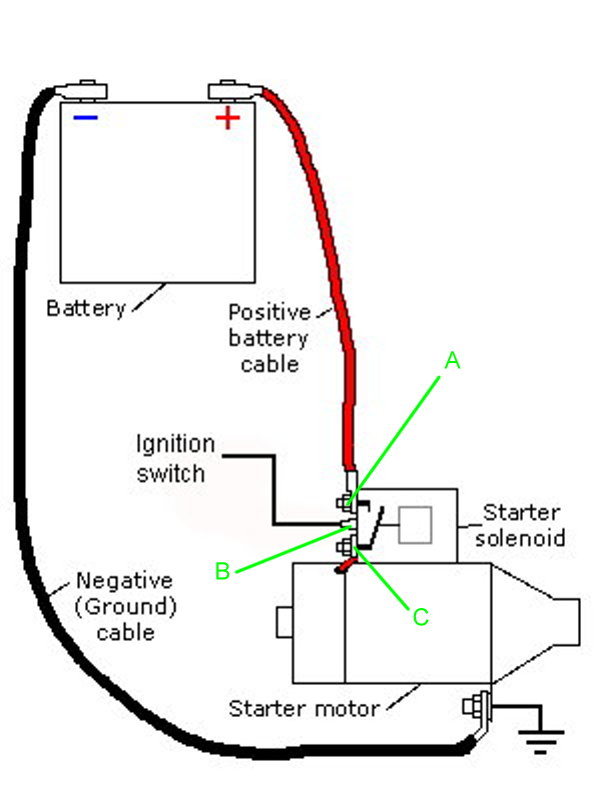

ScottDabinett wrote:Car won't start at the moment. When you turn the key the starter engages but then nothing happens. If you engage it then run a suppy from the battery to the starter it will start fine! Any idea's? A wiring problem?
Any more info, as in what size wire from where to where.
Diagram below to help explain to us.
If it's the common clicky starter problem, it's easy enough to sort out.
However I don't know if its a breakdown of the wiring or the start switch
that causes this problem.

- STA.jpg (49.76 KiB) Viewed 11549 times

Darrel when I need to start it I run a wire from the battery to C on your diagram!

Going by that the ignition switch and small wire is OK, as it energises the solenoid.
The solenoid is putting the gear in the flywheel but not making the large electrical connection
needed to start it.
It is possible that the large positive supply wire is broken or not connected properly, but unlikely.
I would remove the starter and bench test it to rule out any of the wiring before getting a replacement starter.

However if the solenoid is tight it may not move fully back to make a connection.
A strip and clean can often cure it if you've been playing in deep muddy water.

Its the small starter wire that's the problem! They seem to go skanky and lose the ability to carry much power!
Do as Darrell says and put in a relay for the starter, and your problems will disappear!

Yep relay sorts ittwiss wrote:Its the small starter wire that's the problem! They seem to go skanky and lose the ability to carry much power!
