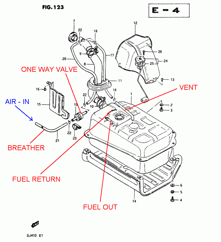

Too answer my own question, may helpful to others.
Found a diagram on internet, there is a second tube connected in filler neck on top side , this tube is the breather and goes back down under bodywork behind rear bumper, by torch light tonight have found tube, hopefully tomorrow will find it blocked under bumper and prob solved , will let you know.
so on a sj 410 does not breath through filler cap but out under rear bumper, for those that go deep wading maybe a one way valve would be a good idea.
Steve
Steve

I have a vague recollection of a small orange valve on that pipe. My cap may well be an aftermarket item.
Re: Fuel tank breather , how does it work ? sj410 1986
I can often hear a vacuum when removing the filler cap, it's never been a problem as it runs fine.
I assume this is caused by the one way valve as it may have a spring to close the valve.
This being the case it will require a low vacuum before the valve would open to allow air in.
Well that my take on it

Your correct Darrell mine was exactly the same, it always used to 'suck' when removing the filler, I thought my orange one way valve was buggered so changed it for a little inline fuel filter, did it make a difference? Well it stopped the sucking noise but didn't effect the running at all, I've been meaning to refit my valve for a while now!

Quick update.
Checked this morning, found breather tube behind rear number plate, blowing through tube with bit of force all is clear, there is a valve in there somewhere as needs a little force, sucking on tube closes valve. So outcome is that it is normal for there to be a little vacuum in the tank, a spring valve regulates the amount of vacuum and stops the possibility of water entering.
So changes nothing but I'm happy now knowing it's normal.
Thanks for the info and diagrams guys.
Steve
