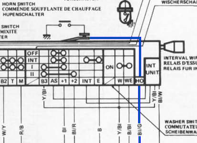

Normally it's just one wire that is earthed when the button is pressed.
Shown as a blue with green tracer.

Right got it, thanks Darrell...
