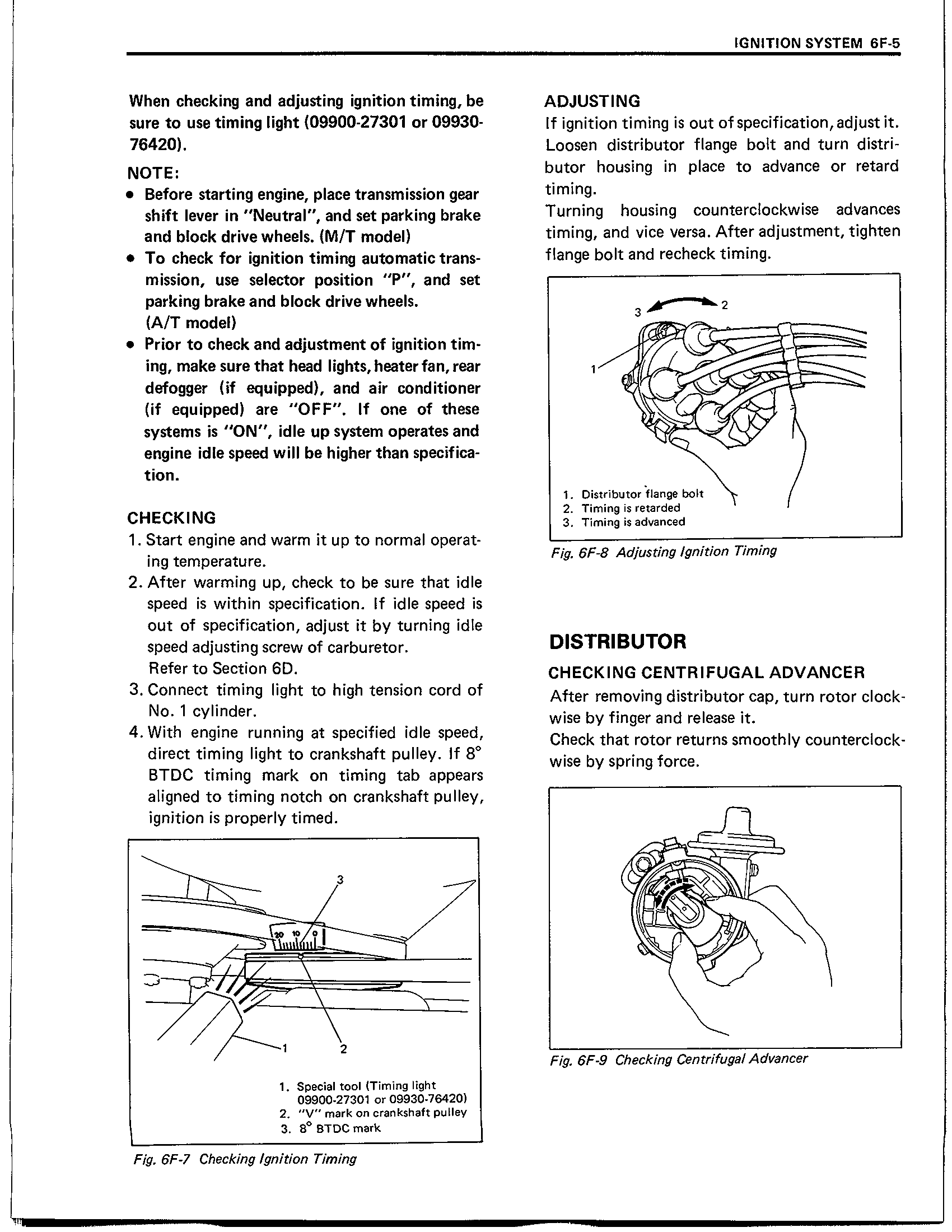

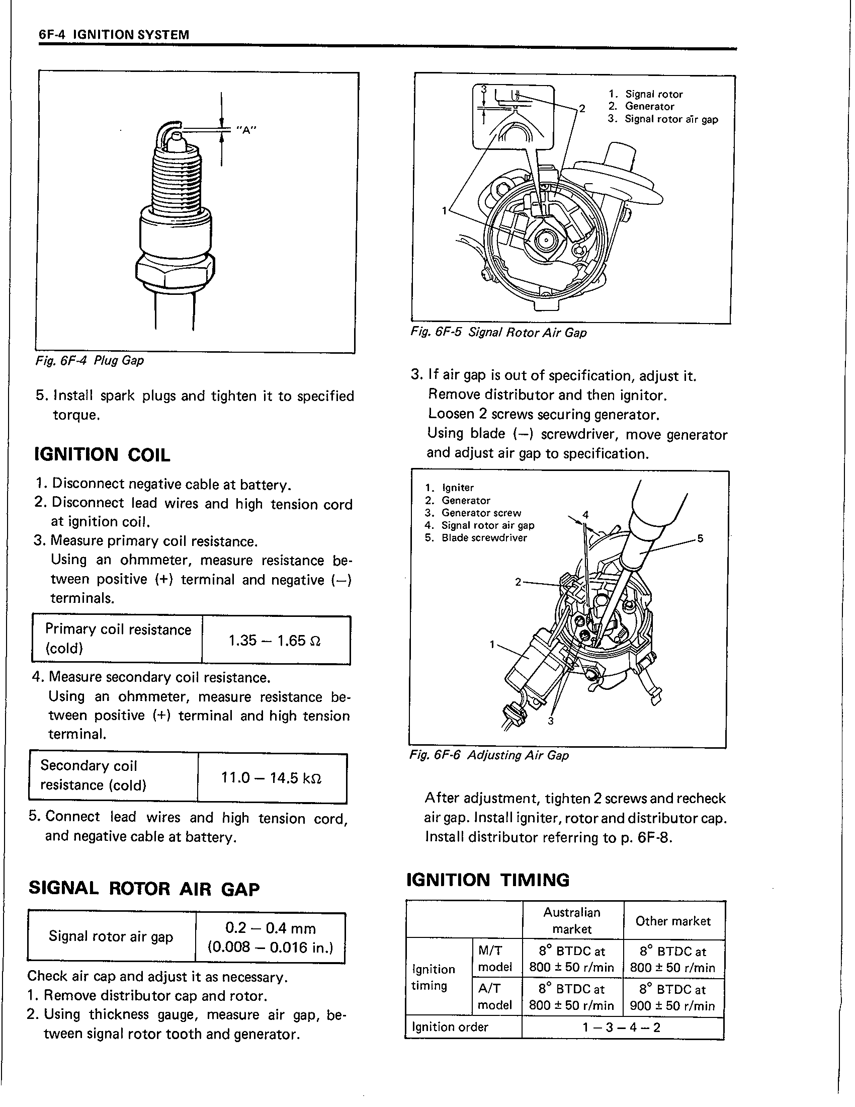

Im going to have a go at setting my ignition timing on the 1.6 8v g16a engine
Anyone know how many degrees I should set it at? Thx
