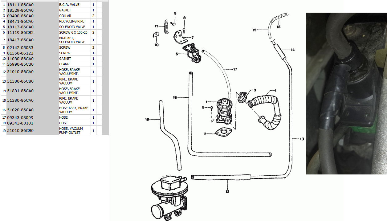

just and update, turned out to be a broken plastic joint for the vacuum pipes. bypassed it for now but it does have a plug going into the bottom of it, what is it?

I would assume that's the solenoid valve controling the egr valve.

cheers dude, will look into it :)
