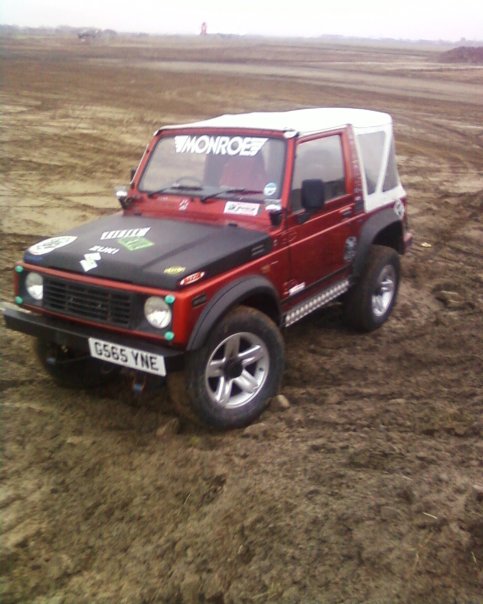

well i bought it in 2007 as my first car i dont have the original picture but it was pretty much bog standard apart from GV alloys with 235 70 16 road tyres and a weber carb with a nice paint job (from what it seamed

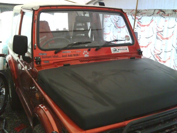

if i knew what to look for rust wise i wouldn't of paid as much as i did for it, all the rust in the usual places so naturally it got a virtual lift as soon as i started welding it and the bonnet re sprayed matt black (bad paint job was removed via large sticker and the sun)
i ended up trying to stick the standard arches on in the new position and got a couple of lights on the winscreen hinge bolts (have been moved now)

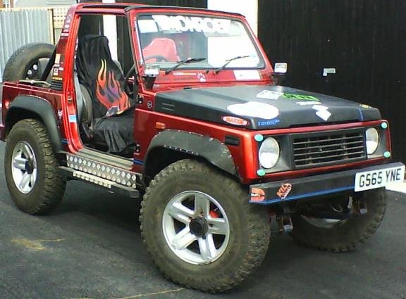

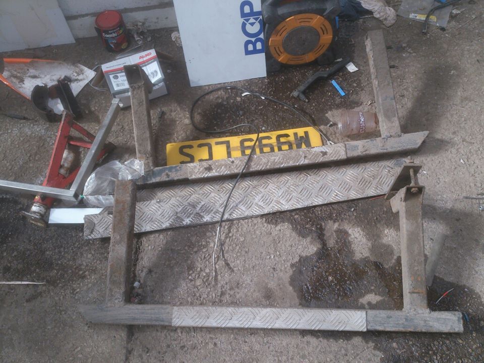

i didnt like them so ended up getting some defender arches (about 3 month between buying fronts and rears) also bought a set of poly bushes and another set of springs (all 4 were rears i think) so i mixed n matched them to get a bit of lift from them and made a new front bumper from a landy series 3 bumper i was given and did some tread plate sill covers too
next i made up some bolt on rock sliders and got my hands on some 215 15 colways on weller 15 by 7s for 40 quid :brows: and got my front arches done

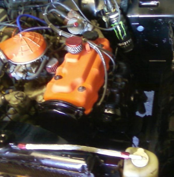

after that came a bit of a spruce up in the engine bay and on the dash

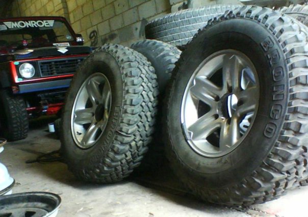

after a few month i was wandering around the scrappy and spotted these

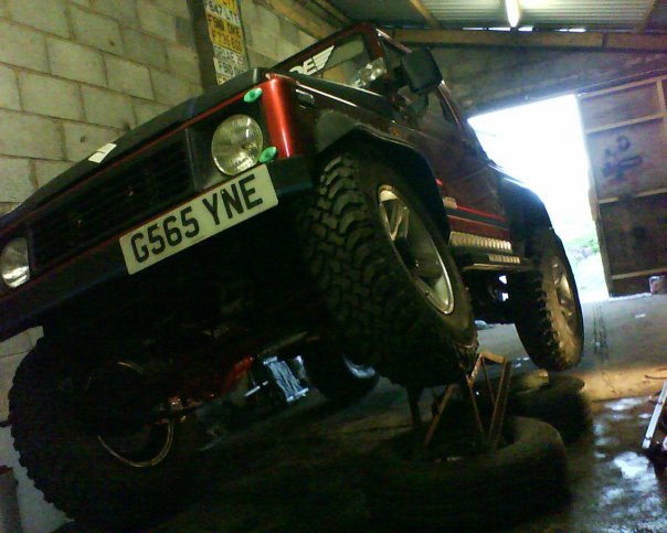

235 85 16 mud tyres and i decided i had to have them 120pound later they were off the landy rims and on my alloys

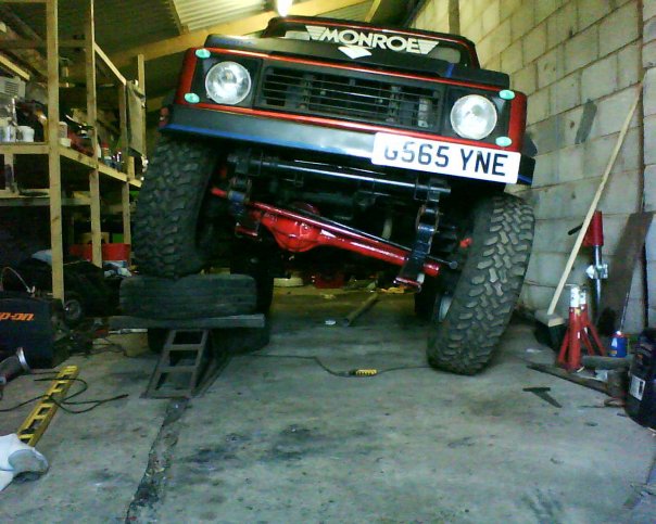

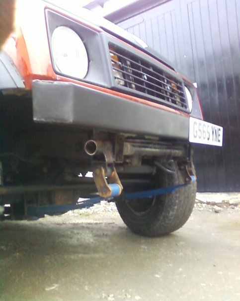

had to have a play with flexing it to see if it caught and i think it got the bulk head so i took the axle off re drilled the perches and moved it forwards 20mm ish it caught the springs but i got wheel spacers much later

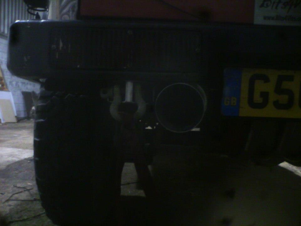

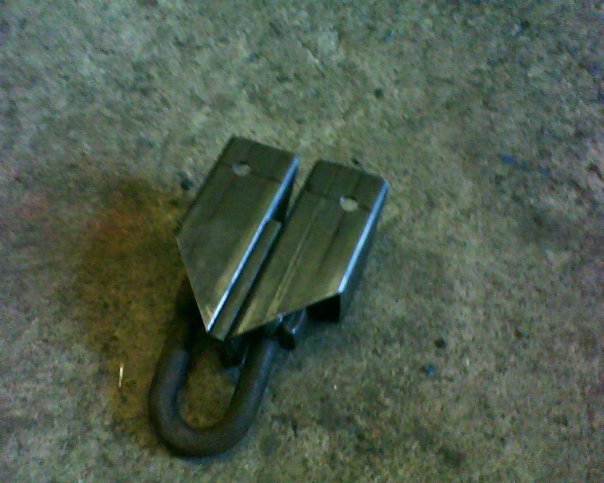

i then decided to have a go at making a rear tow point

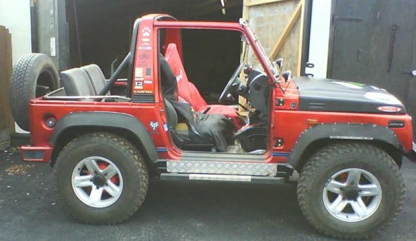

then came a day i was bored so decided it needed removable doors
before it even got its mud tyres it had already passed its test . .. i hadnt tho :screwy:

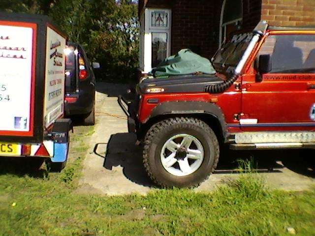

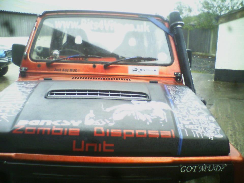

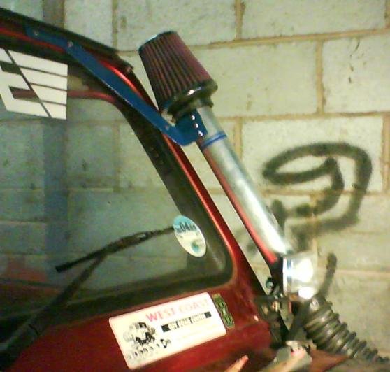

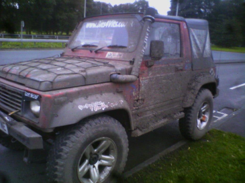

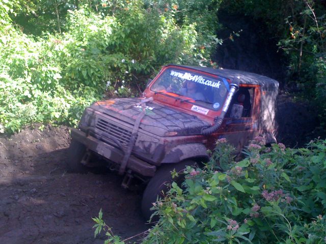

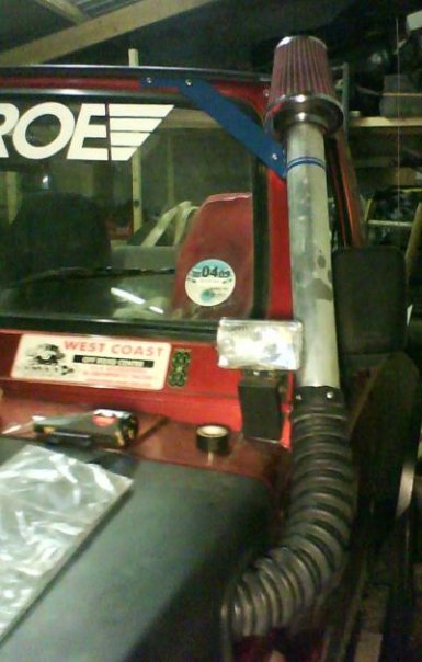

i had a few spare parts nocking about so i made up a snorkle for it out of a bit of large bendy hose and some alloy flue pipe off a boiler and made it fit through the side of the bonnet as it made more sense than cutting a hole in the wing

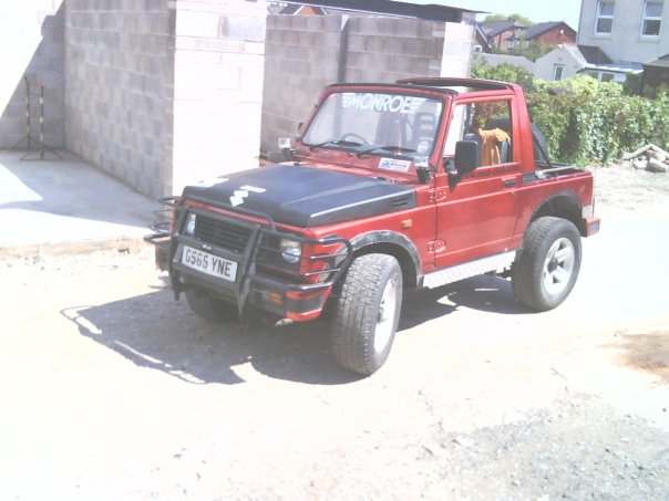

after that we moved house and got a work shop as we had set up a family bussiness and i started driving it around the industrial estate and private land for a bit

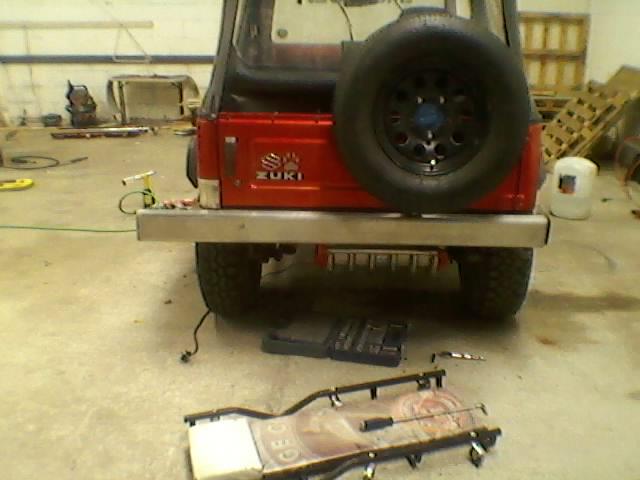

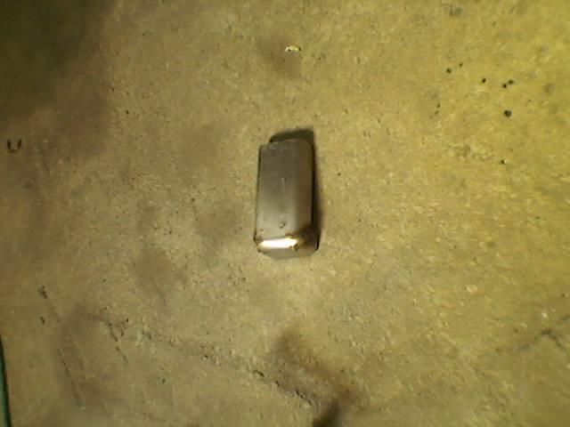

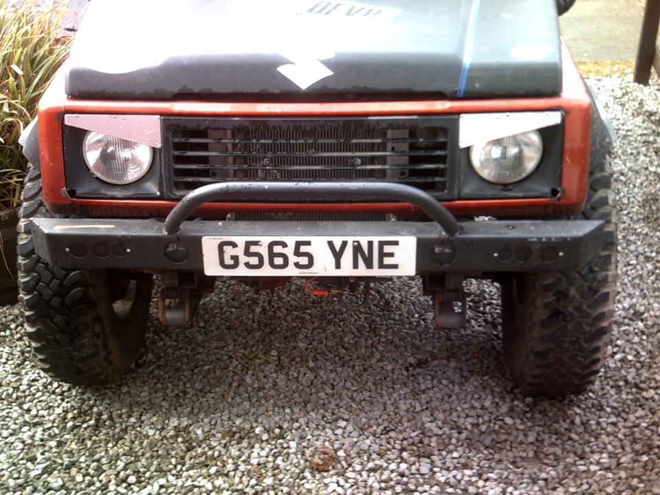

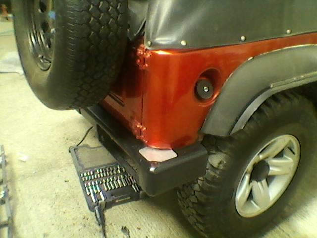

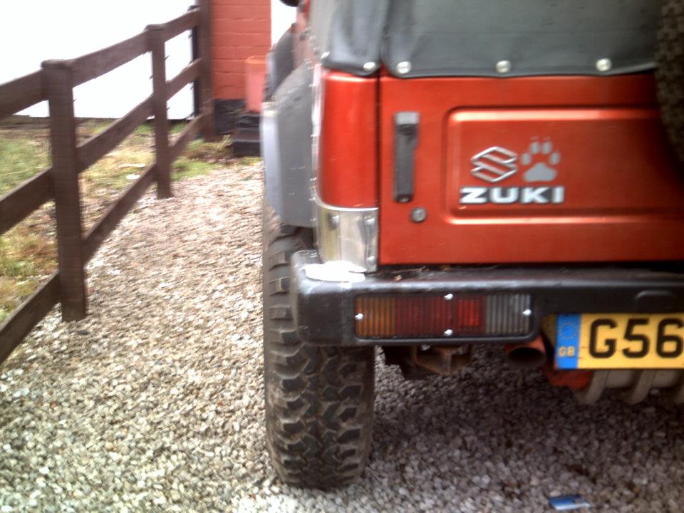

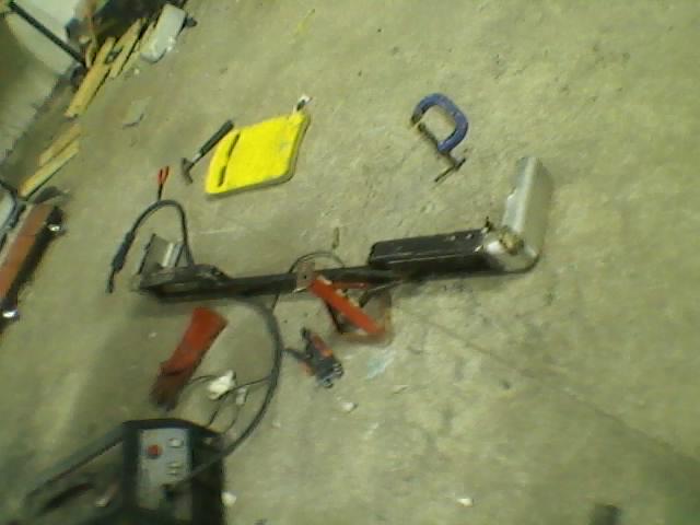

i decided the bumpers wanted changing up a bit so i welded a bar on the front bumper moved the standard lights into it and made some metal end caps for the rear from stainless (it use to be a catering light i found in a skip) even thought about covering the full rear bumper with it as it was almost a perfect fit over it also made up a new tank guard from a navara A bar cattle grid i was given

made up some new light guards for the rear from an only industrial fridge vent (from the skip :brows: )

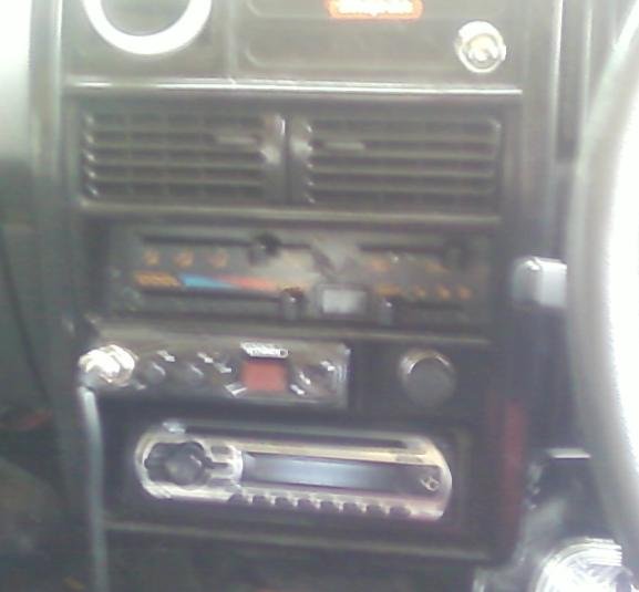

i then had more accessories that needed switches (sub, lights, cb, air horn, reverse light, immobiliser switch and soothing else) and the original clock was long gone by this point
made up some eye brows to partly cover up the holes from my stupid green lights i fitted :screwy: :yuk: also i think they look cool :smokin:

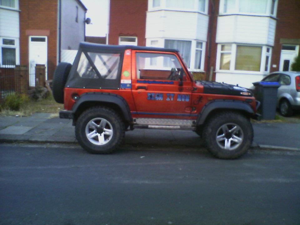

i then moved back to my mums place and got a job that actually paid so i got a set of 32mm wheel spacers here a before n after
no more catching on the springs so did a little work to her (only minor things like lights etc) and got her on the road in 2012

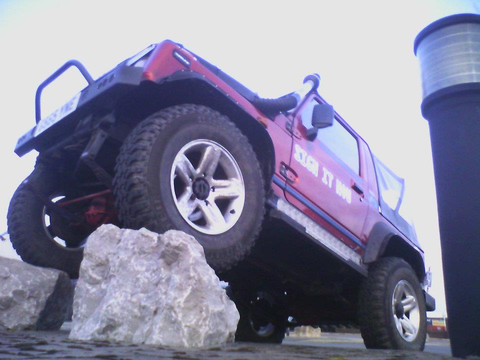

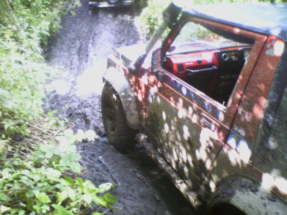

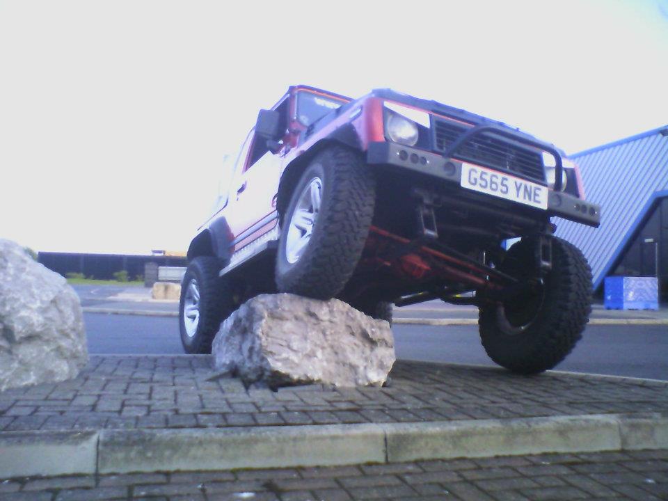

then at work the next day i found a rock
then i found 2 rocks
601020_10150968206442719_1346750745_n (1).jpg (67.96 KiB) Viewed 10146 times

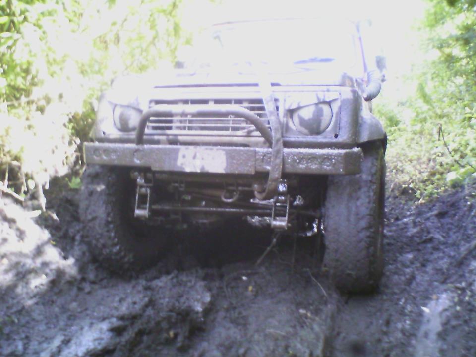

and then loaded up some friends and headed to garstang ford for a play

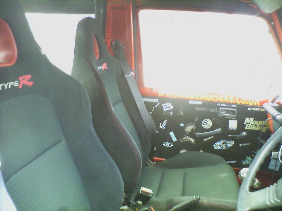

asked on facebook and got some new seats off minimog(tristan) for 75 quid and gave my friends a lift near by the day i went to pick em up so i didnt need to pay for fuel :rockin:
got home and had them fitted fairly easily on their own runners

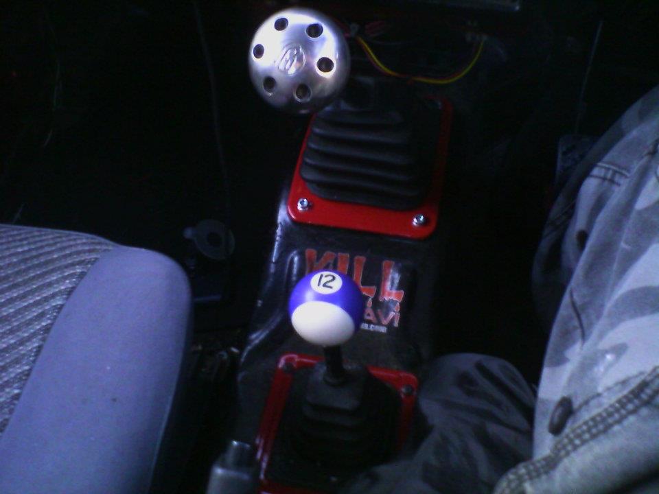

at some point i robbed a 12 ball off my mate so i made it my Tbox knob :brows:

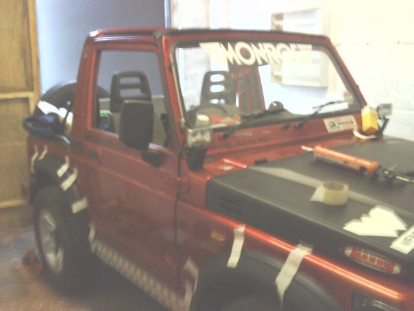

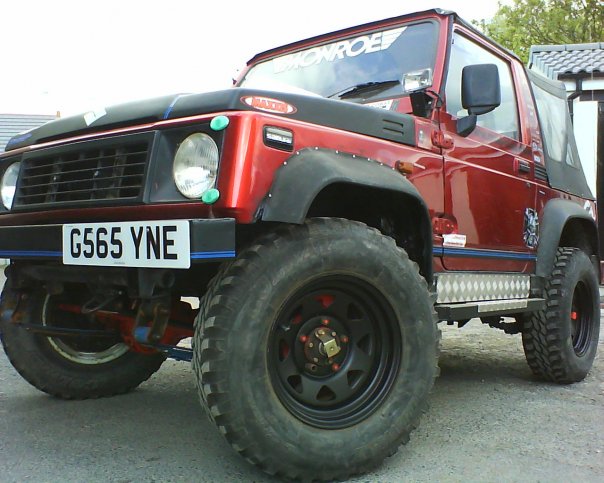

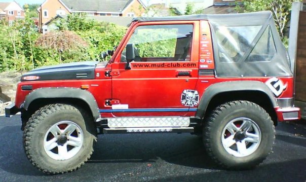

also i got fed up with my tyres catching the arches on bumps cos they werent wide enough so i bought some 'unbrakeable' defender +2 arches that suspiciously came in a box marked fragile (considered sending them back because of that)
so i got those on
no more catching now and very little rubbing offroad too :doublethumbs:

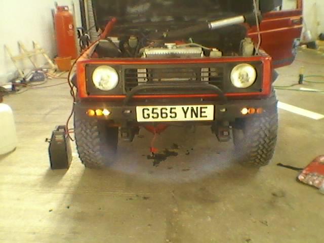

i got a bit of a rattle on my 1.3 conveniently when a 1.6 8v engine came up for sale for 125 with a sj gear box and clutch . . . so i decided to buy that and get it fitted luckily i already had a skinny starter fitted 8-) the carb was junk so i decided to put my weber on it off the 1.3 . . . turned it over and a very loud bang and flames came out of the carb, ive never moved so fast in my life, i cleared a 50 foot work shop in the blink of an eye ducking under a car lift too :oops:

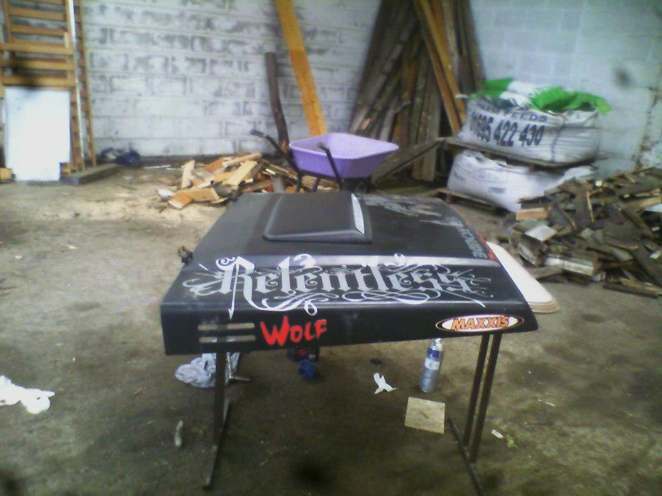

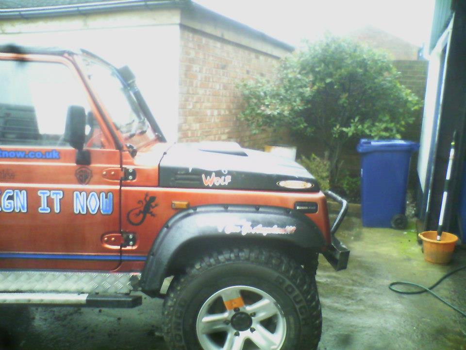

after a while i noticed a dent in the bonnet where the bolt on top of the carb was digging in and starting to rub a hole so it got a bonnet scoop off a trooper for a tenner and a bunch of holes drilled in the bonnet under it to help keep it cooler altho it didnt really need it

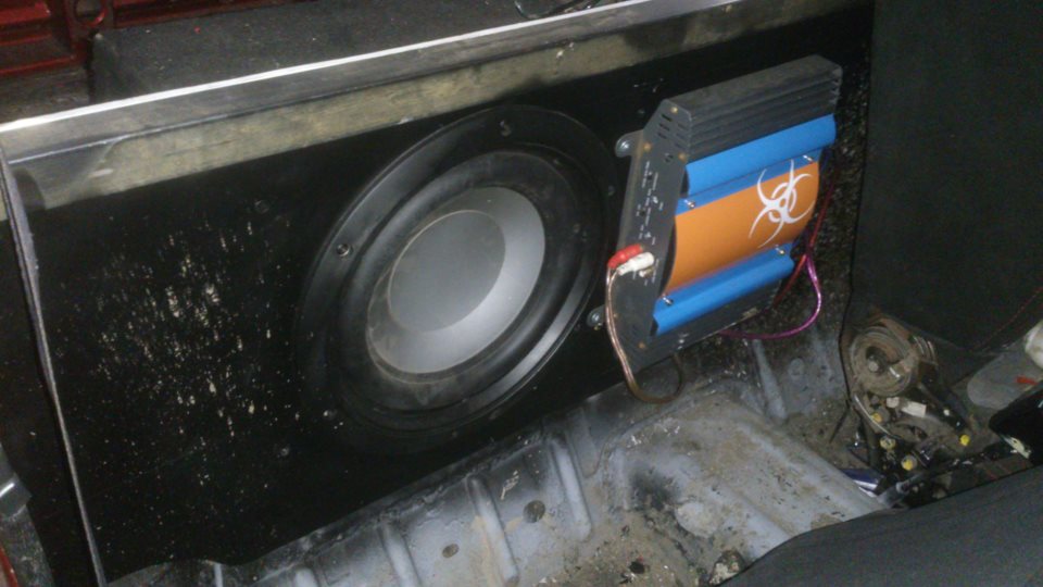

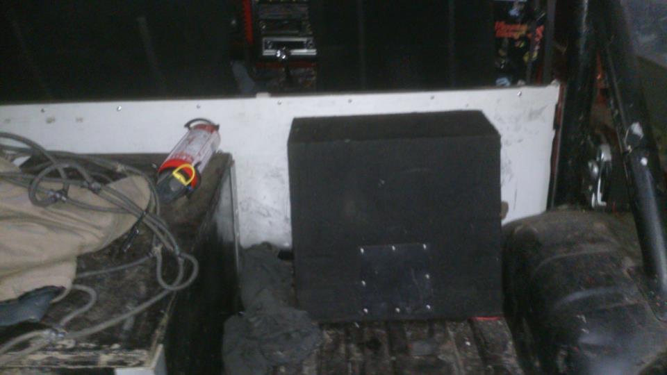

i then decided on doing a bit of a temp pick up to it so stuff stops falling under my seat only needed angle iron some inch n a bit box section and a sheet of 5 mm plastic all just glued and riveted in place . . . and had my sub mounted to it

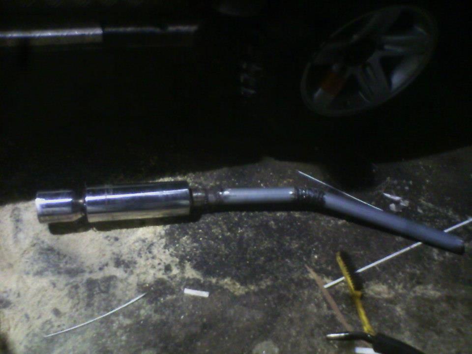

my standard back box then blew up on the way to a car cruise :oops: so when i got back to work the next day i went to see the guys who were braking cars on the industrial estate i was working on and got this for 15 quid just because i needed something there n then
a big fooking jap drift cannon :hahaha:

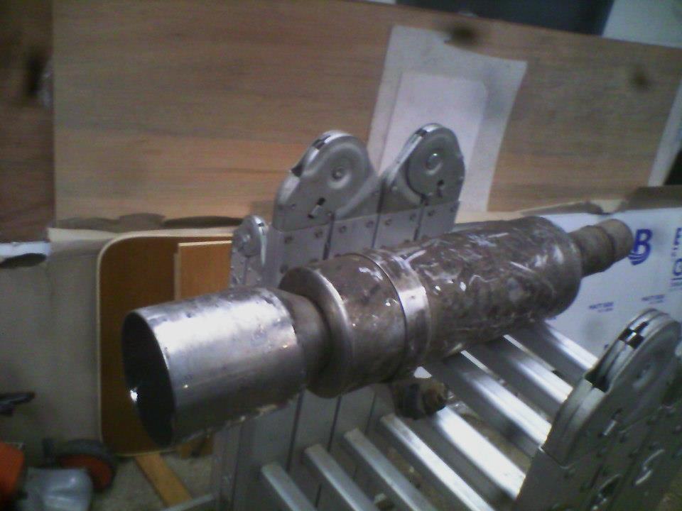

so i made a pipe to make it fit from some 52mm exhaust pipe i had lying around and jammed a bit of 1 inch box into the bend to act as a baffel as i knew it would be too loud for me and then just got it welded to the rest of the original back section after the flange

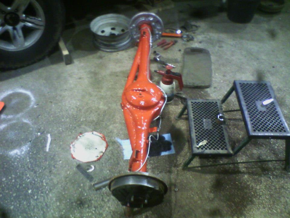

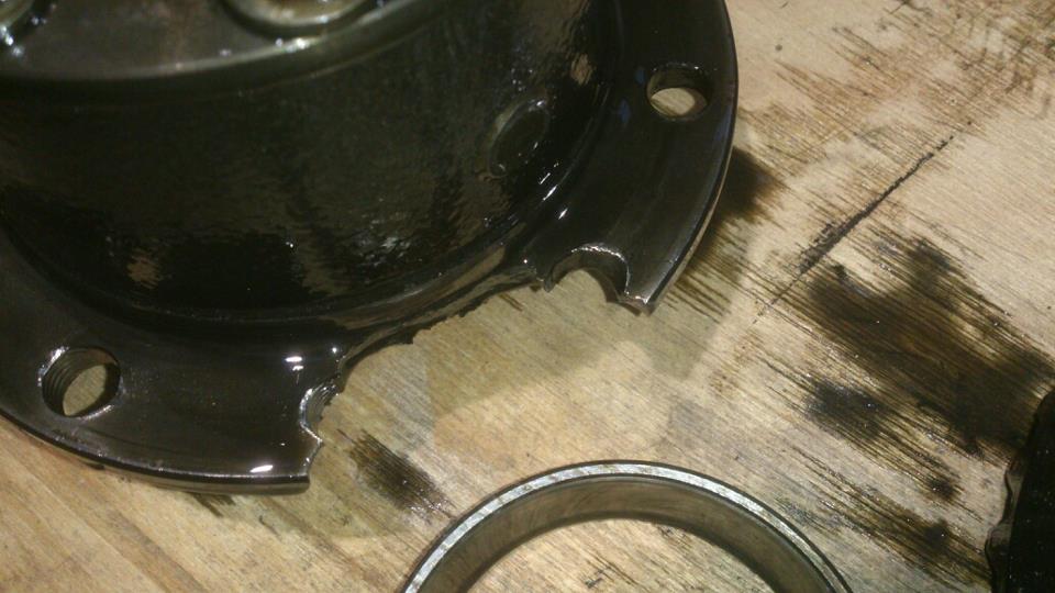

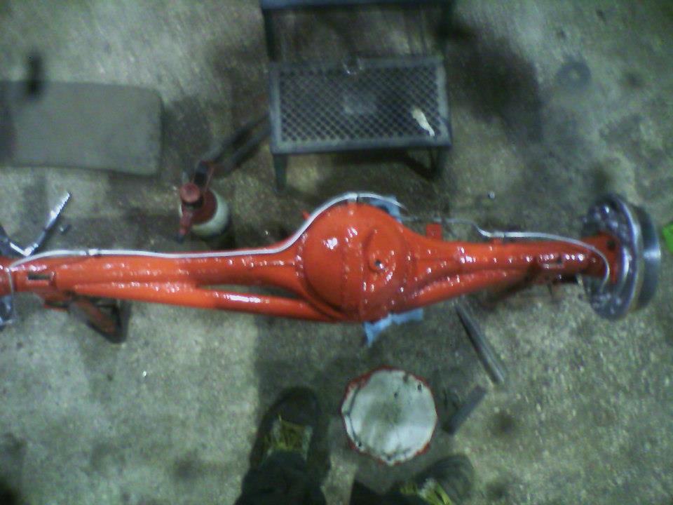

a few months passed and then my diff went boom and blew a hole in the back axle (stuck it in 4wd and carried on home) so i took it out and did a temp repair until i could get a new one and also welded up my axle . . . and i figured it would be rude not to brace it while it was off

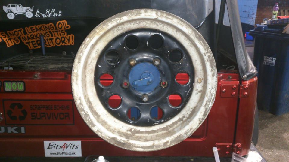

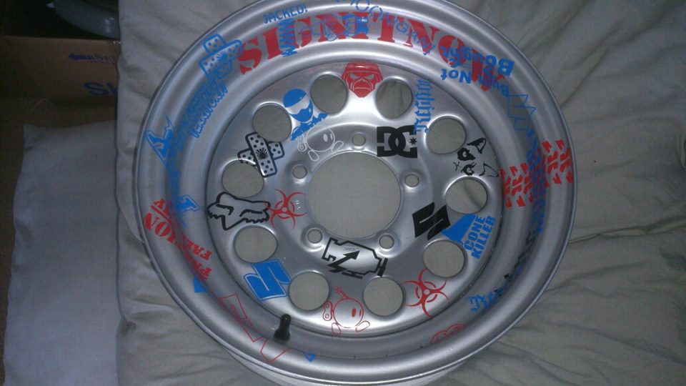

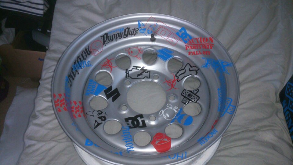

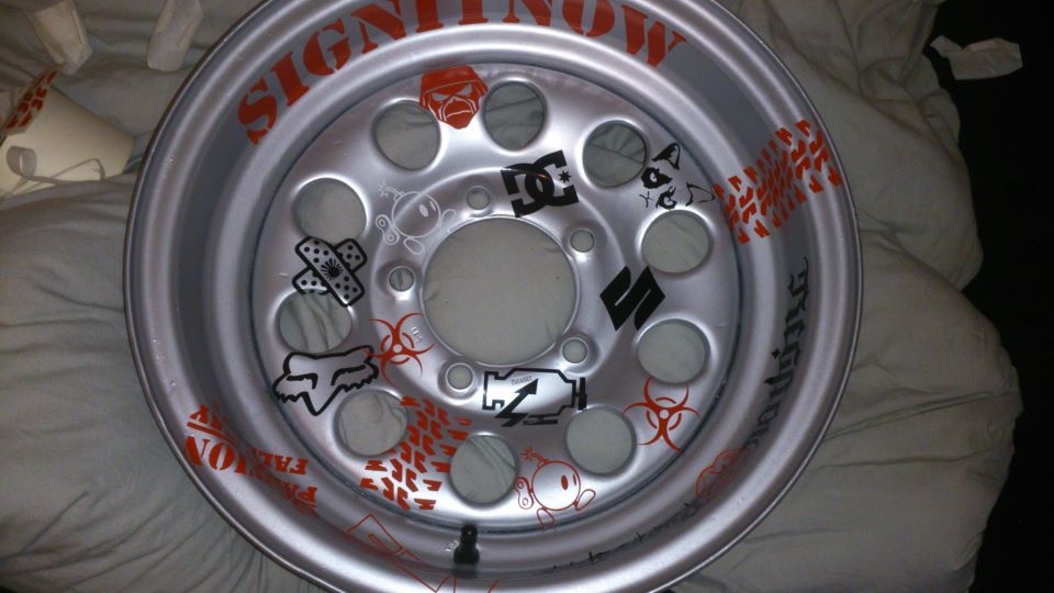

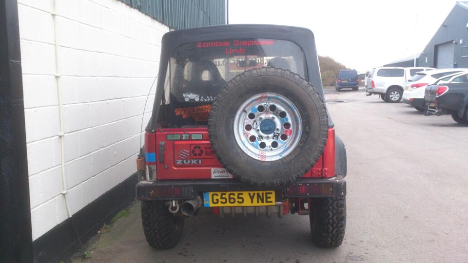

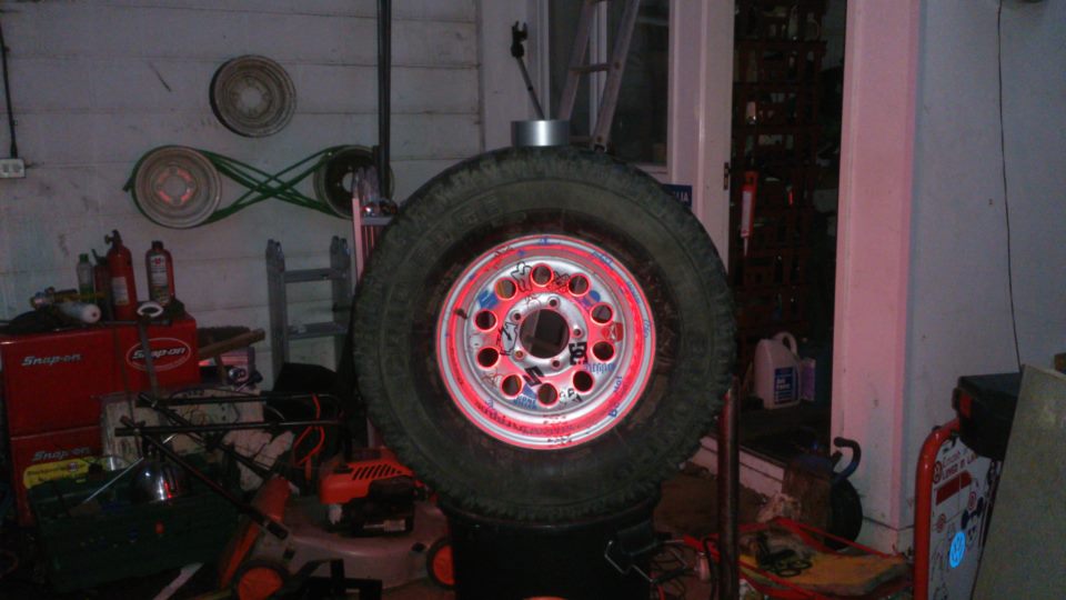

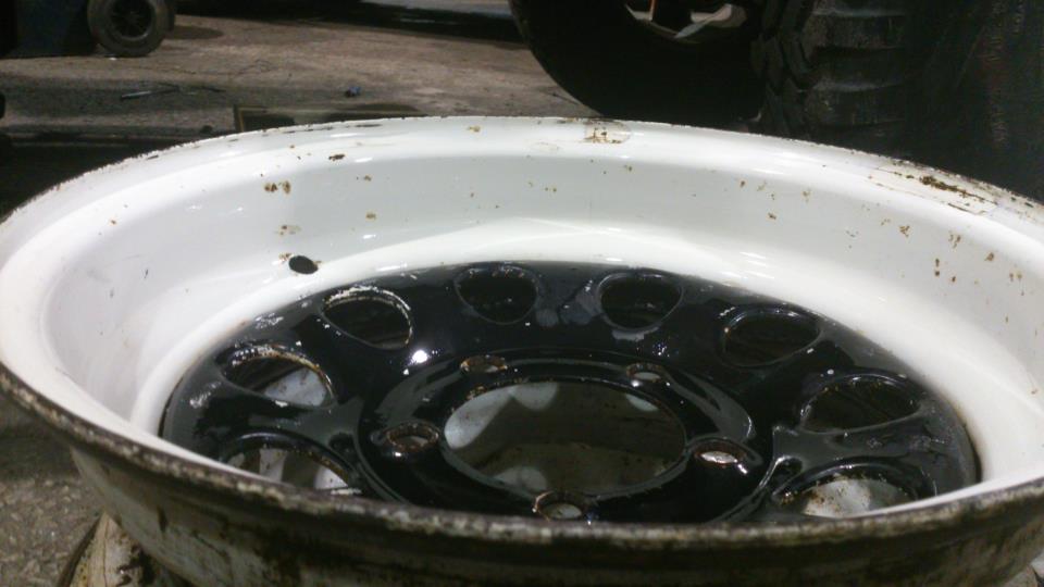

i later got a riveted 16 inch landy rim so i decided to make a hybrid wheel using my suzuki center as i wanted to run a full size spare and it roughly matches the offset of my gv alloys too 8-)
paint wise i decided to just keep it simple and spayed it silver . . . but as i was still working with my dad in a sign writing company i made a couple of stickers for it
and then got carried away a tad

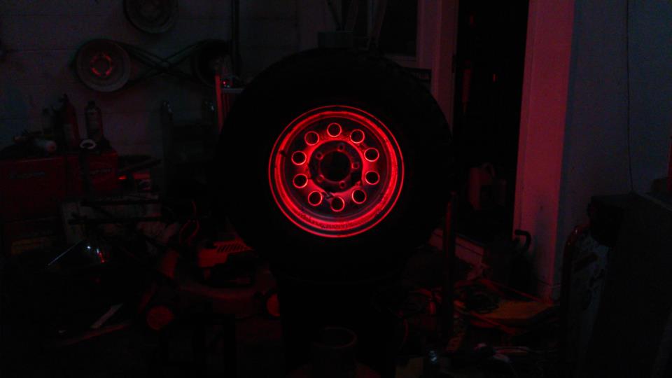

the tyre i fitted to it was a tad fooked to be honest and its emergency use only so i decided to fit an led strip to the inside of the rim to use as a 3rd brake light(or tail light i forget)

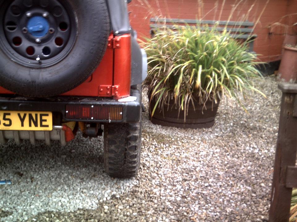

the wheel carrier needed a bit of a tweek . . . just cut n drilled the welds and moved it out n up so the 235 85 16 cleared the bumper ok

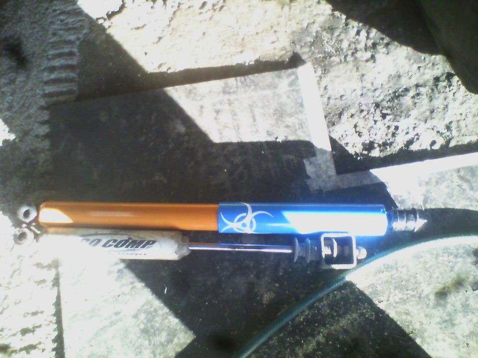

at some point it got astra shocks up front not entierly sure when :er: and i decided to wrap them in vinyl to brighten them up a bit . . . pretty sure they are the gas ones but not certain any more

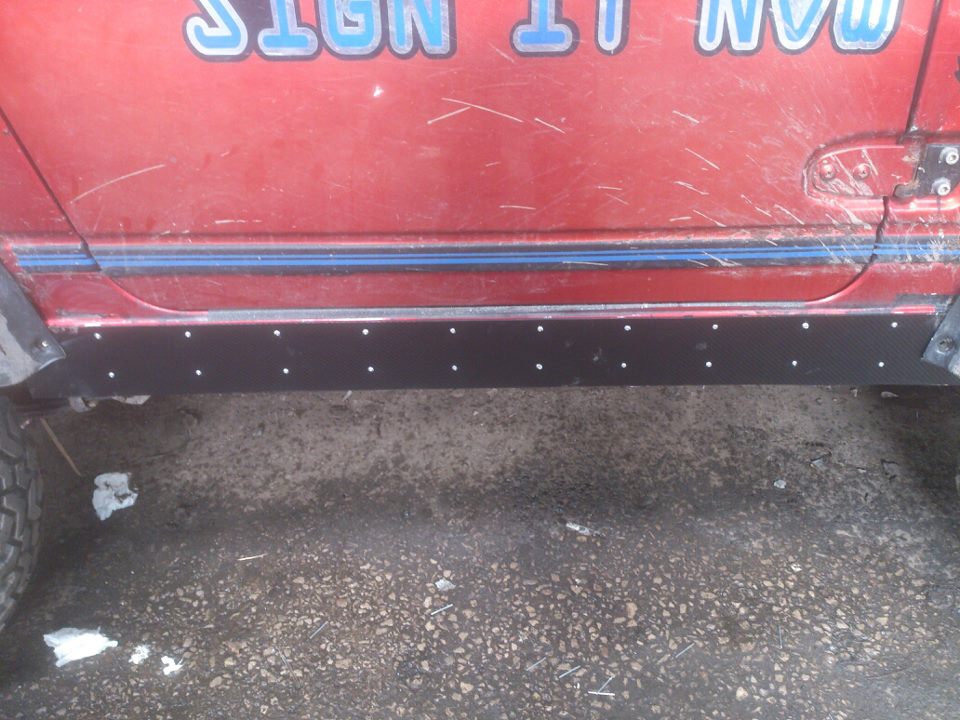

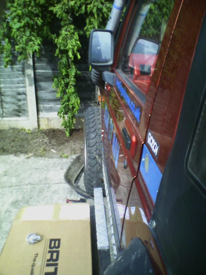

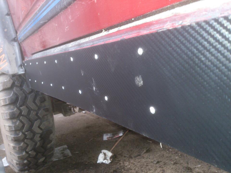

tread plate sills needed to come off for a spot of welding and they stayed off as they didnt fit right with the new arches so i made up a set out of aluminium composite panel and wrapped in carbon effect vinyl (we must of had about 50 meters of the stuff that we bought dirt cheap)

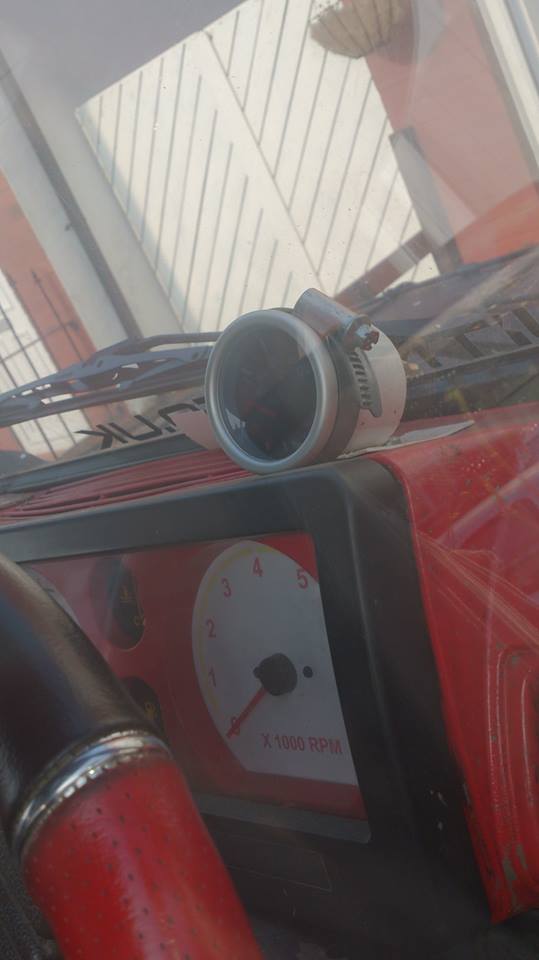

my professionally fitted water temp guage

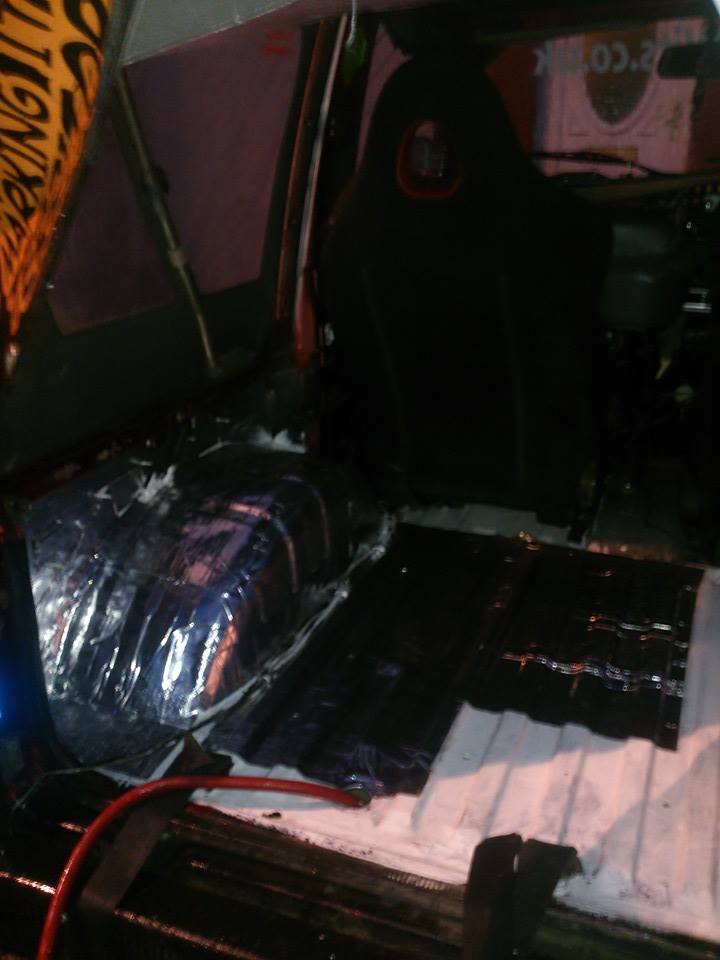

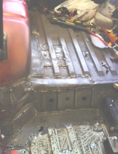

first thing i did was rip out the bulk head behind the seats (luckily i made it easy to remove :guns: ) and found my rear seats and seatbelts ready for it to be a 4 seater again

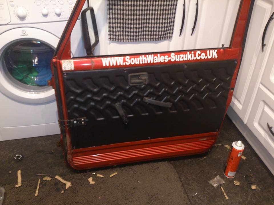

then i decided it needed new door panels after my old ones were painted hard board :yuk:
made these up

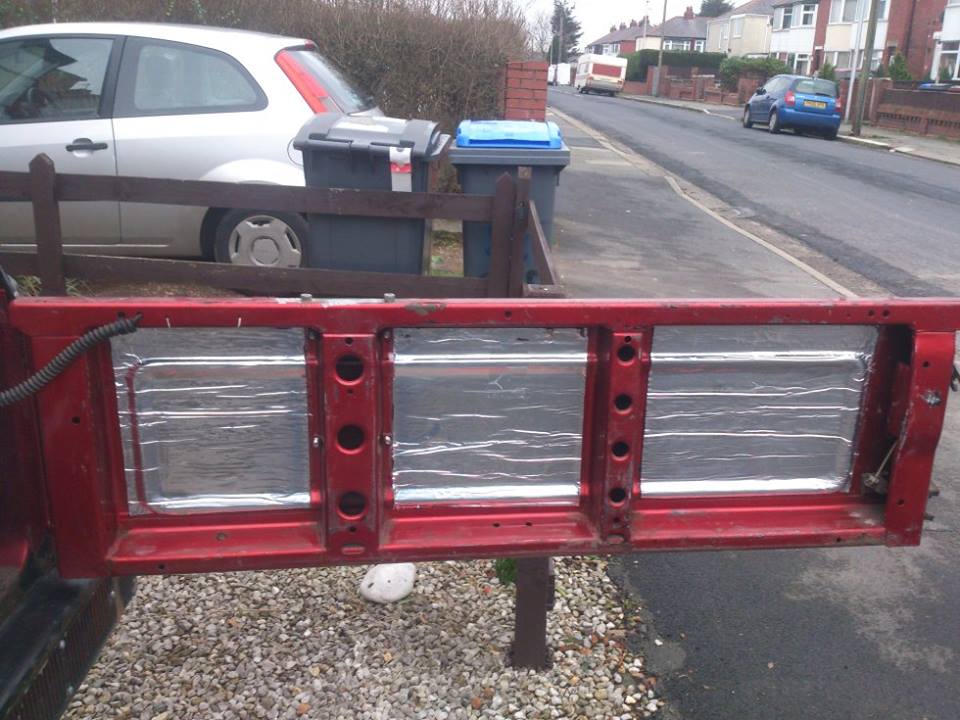

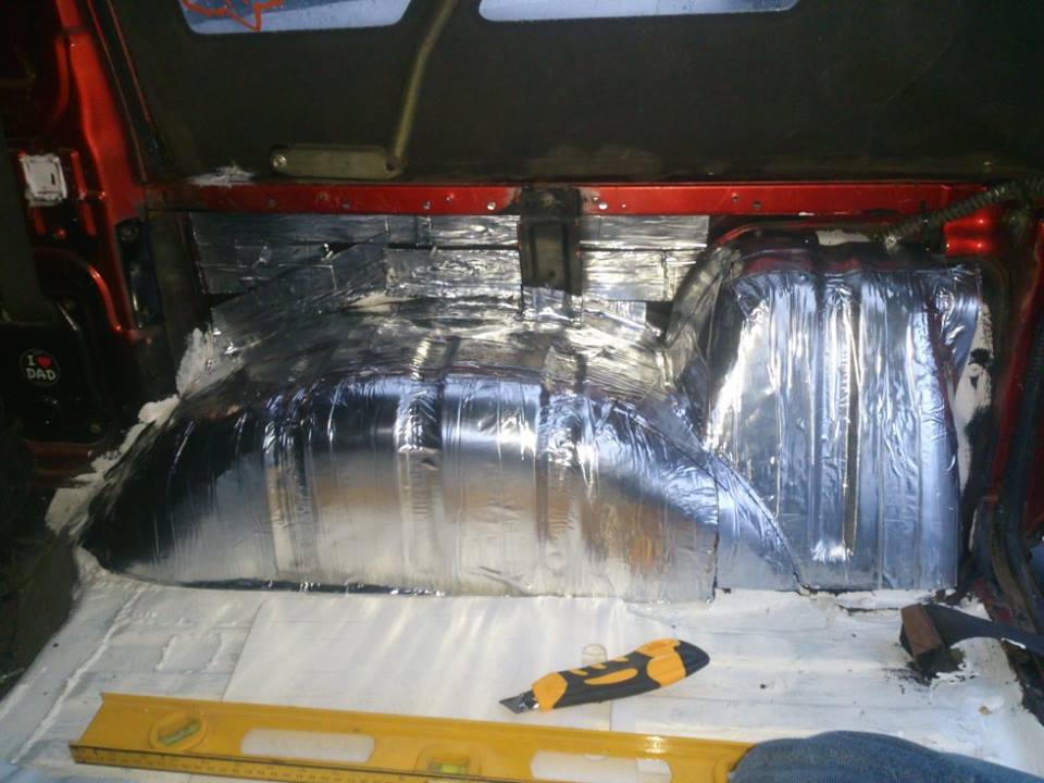

and now im at the stage where i'm adding rattle mat through out and then going to get some carpets in there too i think
