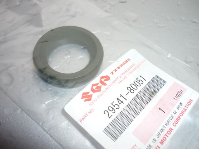

Re: leaky transfer box
I was just wondering what peoples opinions are on this.
There is no seal , just an outer gaiter.
Does the shifter bush act as a seal or does the slot on the shifter allow oil past ????
I know I've seen quite a few pics of the bush breaking up.
I know this is not a proper seal but it's only got to stop oil splashing up.
I dunno
I dunno
Think its only the gaiter that dose the job, when mine split water got in and filled the box. then a lovely grey and pink cream substance started leaking out
