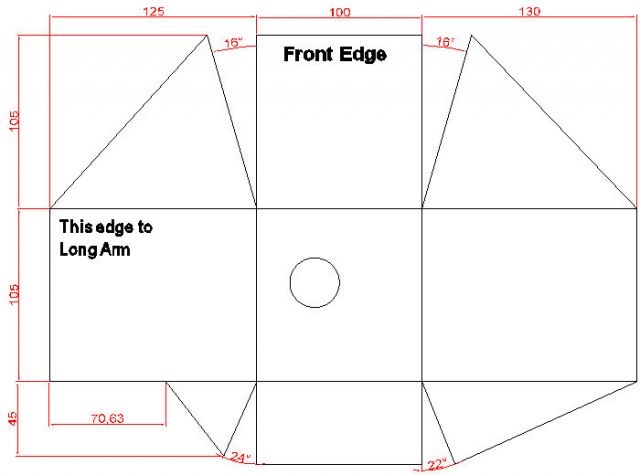

Transferbox guard template
Post by ScottieJ » Tue Mar 04, 2014 4:15 pm

Ok ideal what's the best thickness metal to use
4” calmini lift kit :)
Re: Transferbox guard template
Post by donkeychomp » Tue Aug 04, 2015 10:02 pm
I used 5mm on mine
Post by dan_2k_uk » Wed Aug 05, 2015 8:59 am
Would have thought 4mm would be sufficient. Look as the strength of the mounts. If you hit a real immovable object its going to rip it off the mounts before damaging the guard.
