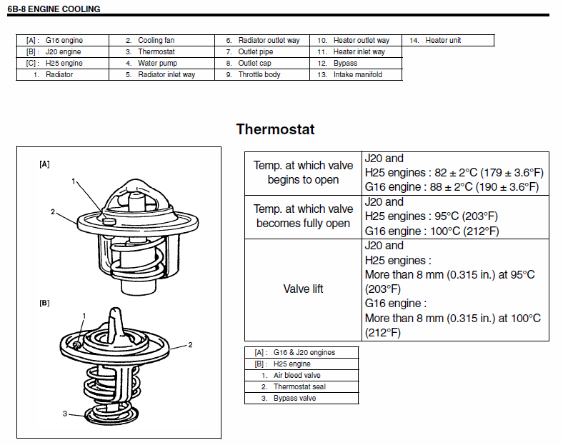

Re: Thermostat opening temperature
Post by Darrell » Mon Jan 23, 2017 2:53 pm
From the 2003 workshop manual..
gv temps.png (77.81 KiB) Viewed 6753 times

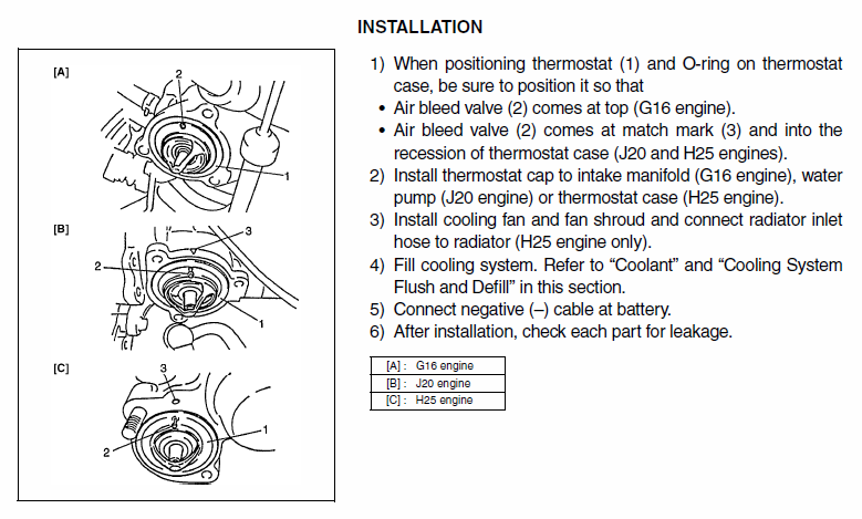

Post by Darrell » Mon Jan 23, 2017 2:56 pm
Bit more info..
